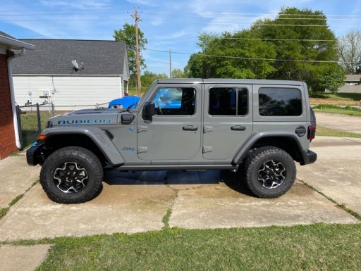

I’ve had my 2021 Jeep Wrangler Rubicon 4xe for right at 2 months now and I love it!!! Any other OB members get the 4xe yet? I’m not a hard core, full time overlander…but I am building this as an “overland” rig vs a rock crawler, or any other category. Just thought we could use this thread to share pics, tips, experiences, etc… on the 4xe for overlanding.
