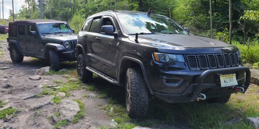

I have a 2018 Trailhawk, modified up the wazoo for off-roading and this thing is a beast. Wrangler and Gladiator drivers are stunned when they see what it (and I) can do with it. But be aware of its limitations: 20 inches of water fording at most, lower ground clearance than you'd get in a stock JKUR/JLUR/etc, and air suspension means no aftermarket lifts and bigger tires. It's also Independent suspension front and rear, as opposed to the Wrangler's beam axles, so no articulation. The Trailhawk edition has a limited slip rear diff that's made all the difference for me. I'll outwheel most open diff Wranglers with it. I've never needed to pull line even once with it.
Perhaps the worst limitation is that there's not much aside from armor available for it in the aftermarket the way there is for Toyota and Wrangler. I have Chief Products rock sliders, heavy-duty sump plate, and transmission plate, and OffRoad Animal steel front lower bumper, hidden winch mount (Warn EVO 10,000# winch), and nudge bar. I wouldn't even consider wheeling this without at least the rock sliders (it's a W-I-D-E vehicle), sump plate and lower front guard.2021-08-21 11.25.27-1.jpg

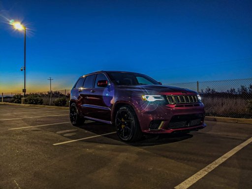

I have 2 WK2s, and have owned 3 total. Our first was a '16 High Altitude (5.7 Hemi) which we sold and regretted that, our 2nd and the wife's current daily is a '18 Trackhawk (6.2 Supercharged), and I just picked up a '17 Trailhawk (5.7 Hemi) for use with my teardrop trailer and as my DD. Needless to say, I love WK2s. The '16 and the '17 had/have the air suspension, the Trackhawk of course does not. As a DD they're just really, really good vehicles. They have their little issues (the '16 and '17 had/have the pano sunroof, it seems they all rattle a little sooner or later, our Trackhawk we got without it) but are overall very reliable vehicles. They're very comfortable (the Trailhawk and Trackhawk seats are a bit better than what's available in the other trims, IMHO), are pretty feature-loaded, and are priced right (I paid ~34k for my '17 Trailhawk with the Trailhawk Luxury Group and the 5.7 with ~27k miles on it).

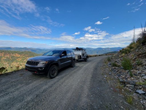

I just did about 800 miles going from North to South through almost all of Idaho from the Canadian border down to the Boise area, nearly all off road in my Trailhawk w/ the teardrop. Average economy on the whole trip was like 12-13 MPG... but the trailer is nearly 3k lbs and almost the whole trip was up/down big mountains. The WK2 was exceptionally comfortable, and extremely well suited for the job. There was nothing extreme or technical, but some pretty steep rocky sections it had no issue with. Personally, I loved having the air suspension so I could adjust it to the terrain... but also it made it easier to level the trailer each night (we moved every day, and often setup camp after dark... so I wasn't unhitching and deploying the jacks on the trailer).
That said... with 2 miles to go back to pavement I got an air suspension fault. This was 100% my fault... I had installed 'lift rods' to level the front and they were a terrible design with little clips that were impossible to install and got lost easily... so I was missing 2 clips. My passenger side rod came off at the sensor, which of course confused the air suspension. It wouldn't be an issue had I left it alone, or got all the stuipid clips on, or used a better designed rod. Of course, now the front susp is leaking down overnight so I suspect I damaged a bag. Again, entirely my fault and I STILL would recommend the air suspension... just my real-world experience.

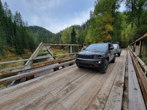

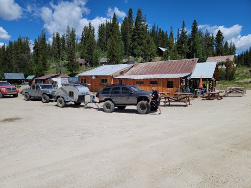

Towing the trailer off road:
Trailhawk and trailer:

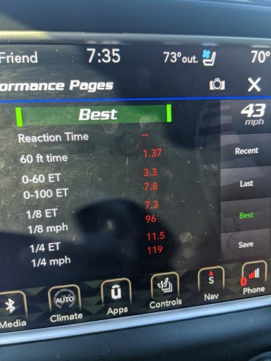

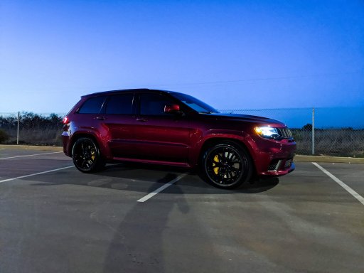

Trackhawk:

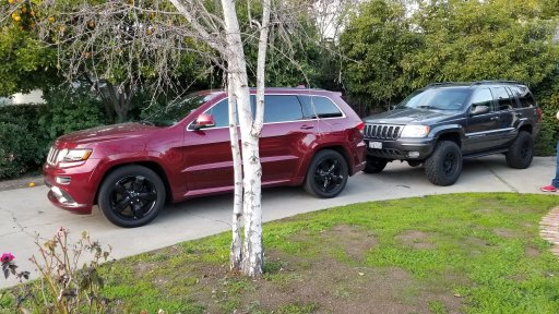

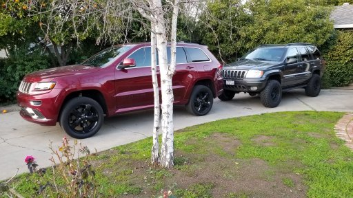

And the '16 High Altitude:

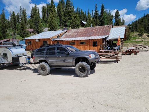

PS- I still have the WJ, it's grown a bit and occasionally gets trailer duty too:
