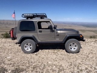

Any TJ hardtop owners have a Yakima rack system installed? Wondering if any issues with the hardtop cracking or leaks developing. Thoughts during a week long overland in the CANY Maze. Plan to carry a Gazelle T3 tent, a Clam 4-sided screened shelter, and traction boards in order to clear some space/organization inside.

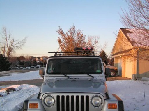

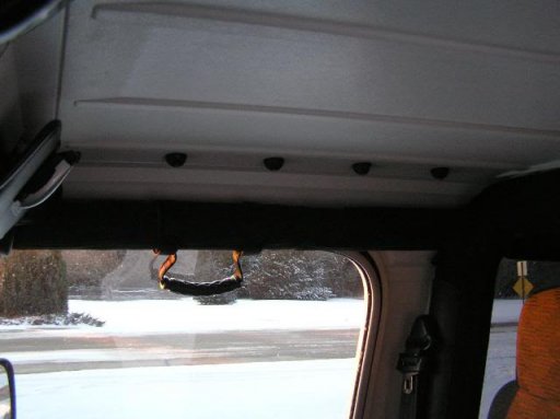

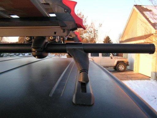

Installed the Yakima rack on my '03 TJ hardtop back in '07. Used it for a few years to haul ski's around but never had any leaks or cracking. I do not think 100lbs distributed evenly would pose a problem for the top.
Below are a few pictures post install in '07. Sorry the quality is sub-par.

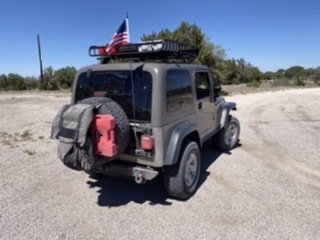

Excellent pics. Thank you for the info. I’m removing my swing out tire & Jerry can carrier in order to reduce weight (and possible yaw movements on uneven surfaces...?). Thinking about a Gobi or Garvin rack but those add weight, although redistributed. The Yakima is lighter, just worried about the lateral G while carrying the above items while off-roading.

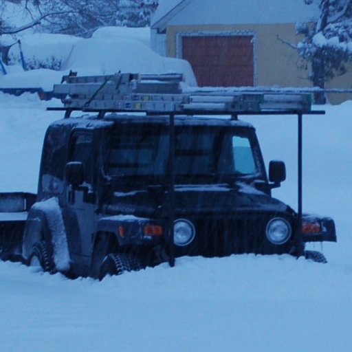

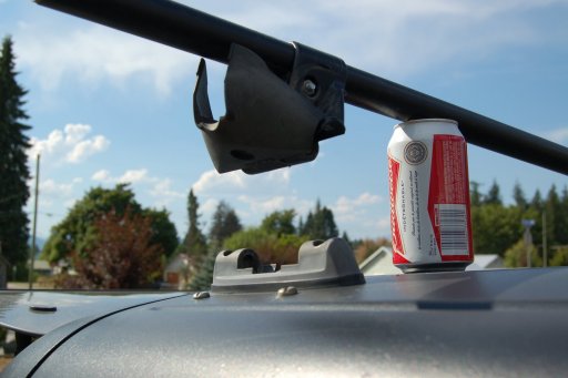

I've used the Yakima Landing Pads, Towers and Bars for years on 3 different Wranglers, starting with a YJ. Absolutely the best system. No issues with the roof or leaking or ???
I added a front bar off the bumper for 16' ladders too.
I'm not sure I would sleep in an RTT tho. I think for that kind of load I'd go for a full gobi style rack off the a-pillars and rear quarters.

Is the Bud can an option for increased load bearing?
Thanks! No RTT. Just to carry a Gazelle T3 ground tent, a Clam 4-sided screen tarp/shelter (small, enough for 2 w/chairs, table, cooler, mini bar...), and traction boards. Combined weight is probably slightly less than your ladders.
