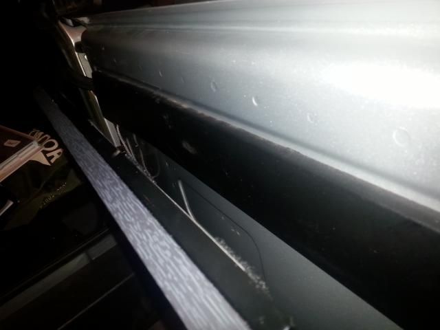

First, I mounted the hinges to the bottom of the shelf on equal sides to make it horizontal. Then, I drilled two holes on both sides for the 550 paracord to go through. I used zipties to mount the hinges to the topmost vent slit on the tailgate. I want to make sure this will be usefull before I actually drill holes in my tailgate. The zipties are quite strong and they do not rattle once tight. I tied the paracord to the bottom side of the shelf equally on both sides and affixed it under the black plastic cover on the tailgate.
Next, I centered and attached the magnetic strip on the top of the shelf. I put velcro on the magnetic strip to help with rattling and ease of getting it off the tailgate (it's quite strong).
The magnetic strip contacts the tailgate metal just above the black plastic molding. This holds quite strong and the table rests a bit on the black plastic...perfect!
