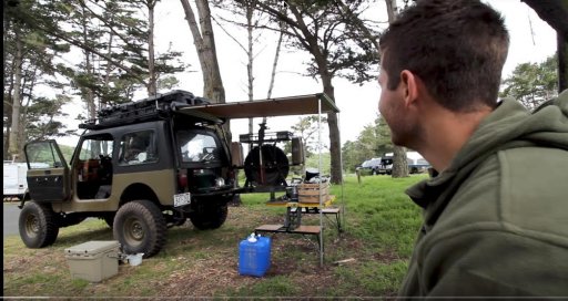

Jake Wettern | iamjake
2,666
Wisconsin Rapids, WI
5315
I live in my 94 YJ and what I found to work the best for me is my blue Reliance 7-gallon rigid aqua-tainer - http://amzn.to/2sB81P6 - and what I like most about this is its square design that slides in easily in the back under the cot i sleep on. I also carry an add'l 5 gallons in a jerry can on my rear bumper/tire carrier
