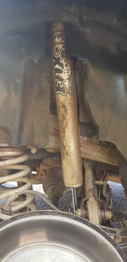

I am planning to lift my Cherokee another 2 inch (approx. 5 cm).
Saying "another 2 inch" because it already had been lifted about 3 cm.
But because of the additional weight (underbody armor, rock sliders, dog cage and roof rack) it is almost back to stock level again.
I am now going to install the MFC 2 inch lift kit, the rear FOX shocks with longer travel and the fast disconnect sway bars (Find 2014-2019 Cherokee KL Suspension Products). The front shocks are going to be replaced by the trailhawk models.
Well, now I'm a little bit concerned abaout the CV shafts.
My mechanic told me that I don't have to worry about...
I would be glad about any thoughts about this.

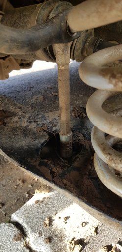

The front and rear shocks are mounted. For the rear Fox shocks I had to build other sleeves to make them fitting the bolts.
The spaces don't work with the longer springs. I will try them with the original springs in a few weeks.
The rear sway bars are mounted but the passenger one makes noise. Going to install the stock ones again.

I wouldnt worry too much unless you plan to go over 3 inches, 3" seems to be the sweet spot for most ifs rigs, if you go over though just plan on dropping the diff to level the cv shafts and sway bar drop.
