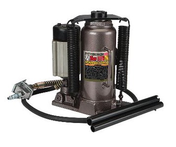

I have a neat 12 ton bottle jack with air over hydraulic. I connect it to my CO2 tank and a quick press of the button and it is up.
I love the combo idea with a jack stand but more important to me is having a large cradle on the top of the jack so it does not slip off of the axle. I am just about finished fabricating one that slips over the top of the jack.
The stabilizing jacks I designed for the teardrop can lift the trailer enough to change a tire.
Interesting, could you post a pic of your set up?
