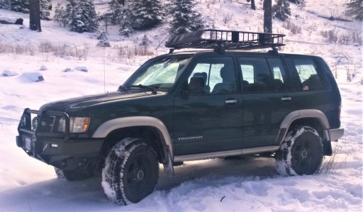

Thanks, the ARB bumper was his college graduation gift. 2" Old Man Emu springs, monotube shocks, powdercoated the factory alloys black, Smittybilt I-rack on spare. We removed the rail mounted roof basket and are going to build a permanent safari type roof rack this winter. Also going to manual front hubs. Good luck on your build, the Trooper has been very "friendly" to work on compared to my rigs.

Very nice. Did you replace the torsion beams with OME as well, or did you just replace the rear coils and do a torsion twist up front? I'm definitely looking at manual hubs... Right after I replace the CVS, maybe at the same time. Are you looking at superwinch or aisin? I've been thinking about making a roofrack for some time, so I'd be interested to see what y'all accomplish!
I do love how much space there is to work on things with the Trooper... You could just about fit a whole person in the engine bay with the hood closed!
