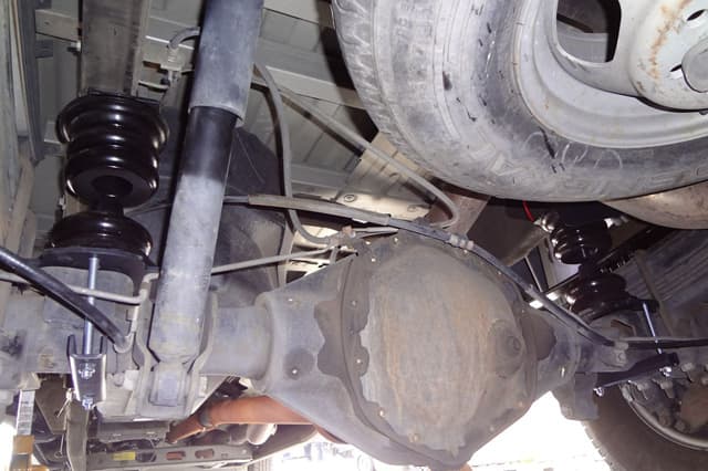

Consider the Sumo Rebel springs. Air bags without air, kinda. And they split so they don't wreck your downtravel. Very popular on Oz Toyota's.
