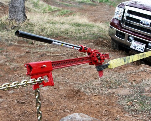

Road pretty much hit it, but a shovel will get you out of most trouble, and if you haven't seen my other threads, I am a pretty big advocate of a well-accessorized hi-lift to pretty much cover every other base.

Yeah...I'm no moderator but here's my experience. When I get that gut feeling and panic... I know I should dial back my approach or turn back in some spots. I always have a hi lift and a shovel. I frequent the beach the most, and sometimes when it hasn't rained in a while I air down a lot and haul about 6 2x10's that are cut down to 4' lengths and if I get in a tight spot I shovel in some sand and build a road. Good luck exploring my friend. Adventure is necessary!
