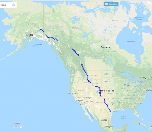

Here is an example of APRS from South Texas to Alaska.
This isn't an all inclusive write up but just something to give you an idea of what you might need to begin your own research to get set up using APRS. I and others would be glad to help if you have any questions.

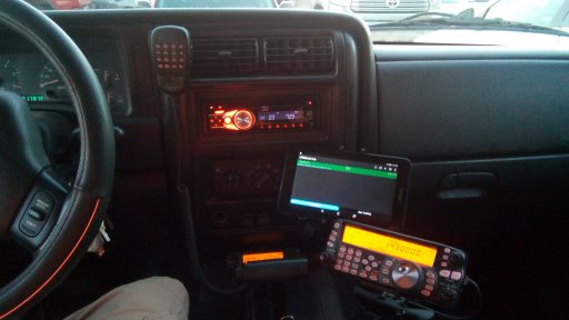

My APRS set up consists of a Yaesu FTM-3100r 2m mono band radio.
I have it connected to a Mobilinkd bluetooth TNC2 with a tablet mounted on the dash and a 5/8 wave antenna on the roof.
Though it in this setup it is an extra radio it is pretty simple and clean.
All of my radios are stowed in the back of the Jeep since both of my voice radios use remote heads so the bluetooth between the TNC and tablet came in real handy.
Here is the "command center" in my previous XJ, I don't have a picture of my current setup as it is not yet complete.

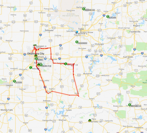

Last year took a short trip to SE/S Oklahoma over 6 days (about 450 miles) and had my APRS radio going the whole time. As you can see the digipeater coverage in SE Oklahoma is scarce. The only packets I got through were to digipeaters between 120 and 160 miles away, one in NE Oklahoma and the other in Arkansas. The other icons on the map are the digipeaters/igates that received my signal and sent it to the web.

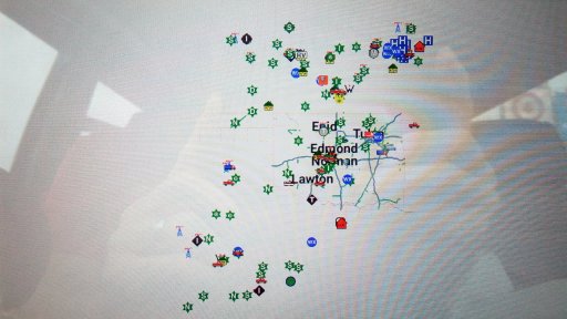

Sometimes the propagation Gods are in your favor and you pick up stations hundreds of miles away.
This picture is the map of stations I picked up this morning, stretching from the Llano Estacado region of central west Texas/eastern NM up through most of Kansas into far NW Missouri.
My furthest terrestrial station was across the border into Mexico or u to Iowa and Illinois. I do wish there was a way to see how far my packets go.
