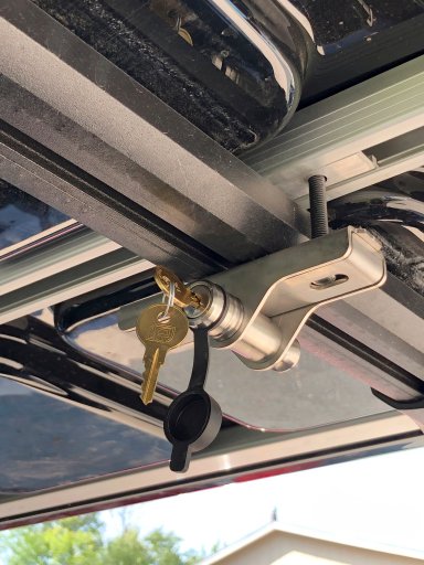

Has anyone bought a set of these keyed roof top tent mounts? I saw them on YouTube and like them better than security nuts
That is brilliant. I used security nuts and the front runner QD mounts with pad locks when I had my RRT. These look better and simpler to use.

From my experience with roof tents and the feedback of countless customers, protection is only of limited use. I will try to explain why. Most holders consist of two plates and two screws. Protecting only the nuts makes no sense because thieves are more likely to use bolt cutters, which are much more effective. If the roof tent is only mounted on the roof rack, an even quicker way is to simply break open the rack base and steal the roof tent including the rack. Four little holes that's you done. If the roof tent is mounted on a platform, the most sensible way to lock the screws is to set a welding point as @NotGumby mentioned.

Soo if you use a lock make sure to secured the vertical screws too. Something like that one here:
