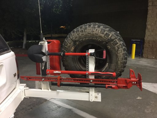

I've recently embarked on a quest to reduce the amount of weight I carry, and get my Center of Gravity as low as possible. I moved my Hi-Lift from the roof rack to the swing out...

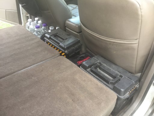

I also got rid of my large water containers, and now carry 12 of these container (filled with H2O) on the floor behind the front seats...
What other suggestions do you have for reducing weight and lowering existing weight?

Go on a diet??? :tearsofjoy: I kid, I kid! Looks like you're already putting some good thoughts into weight distribution!
  1. Water is a big one actually. I know a few guys that run around with 10-15 gallons of it, when 5 gallons and a good filter will get you just as far.
  2. Another big one is your battery. Replacing a factory battery with a more compact one (group 34, dual cycle) can save you a decent chunk of weight. If you have somewhere to put it, relocating a battery is pretty simple as well.
  3. Just like a backpack, load your heaviest items as low as possible. Lightweight, fluffy stuff goes on top.
  4. For overall weight, you can look at aluminum armor instead of steel. Usually a bit more costly, but significant weight savings. The downside, of course, is that it won't withstand quite as much abuse.
  5. Looking at your picture, I would also suggest moving your tire & fuel mounts down as low as you can without interfering with anything.
LOL. Does this mean I have to stop working out my upper body? ;-)
