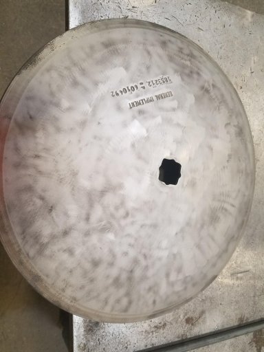

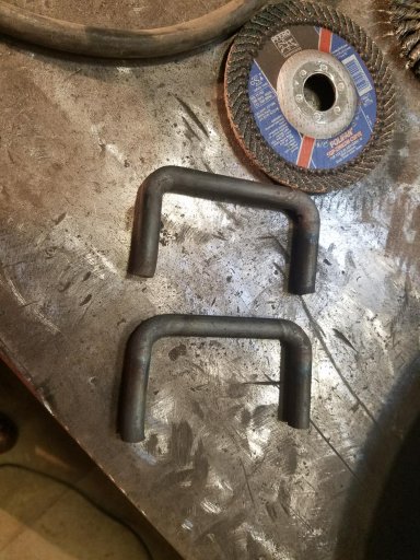

This was today's project. I picked up an 18" disc blade at a agricultural dealership since I don't have access to used ones anymore. These things have gone up in price, $30 and they have a thick paint job now.20170308_110005.jpg I sandblasted the disc on both sides, then cut a piece to fill in the hole.20170308_115937.jpgView attachment 18323 Then I bent up some handles and burned it all together View attachment 18324 Sanded down, alomost done. I filled in those little holes and sanded it out.20170308_123719.jpg I bought a turkey fryer at Walmart on clearance for $20. 20170308_131307.jpgI put the fryer together and fired it up. I washed the skottle then got it hot and threw on some bacon, because bacon grease works so well for seasoning pans. And because I was hungry and we had bacon.20170308_134648.jpg I ate the bacon while I put this post together. All in all, a pretty successful day!20170308_135200.jpg
