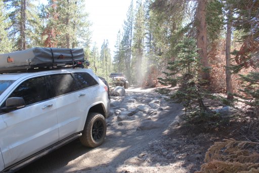

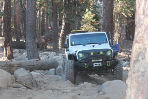

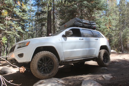

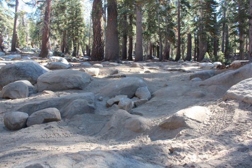

The trail is pretty much just fire road until you get to the gate keeper. You can either go for it here, take an easier line to the left, or a bypass to the far left. My WK2 made it through the easier line not pictured.
The combination of boulders, super powdery dirt and lack of clearance made the journey an arduous one for me. Thank goodness for skid plates and sliders because the rocks have my armor all over them now! But these Jeeps made quick work of them.

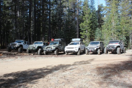

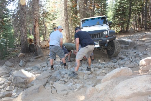

About 2/3 of the way in I got high centered pretty good. And at the same time, about 100 yards up, two other guys that were not in our crew were hung up and winching themselves over the next obstacle. So after much effort to get unstuck, and with darkness looming, the decision was made to punt and make camp along the trail somewhere. Lucky for us our punt spot must have been a common spot because we spotted an existing fire ring and just enough spaces for the Jeeps. No stuck pics, but I took these the next morning of where it happened.

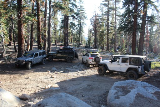

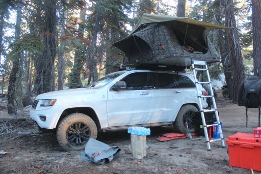

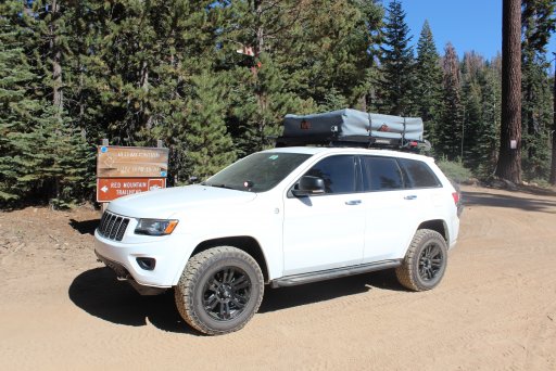

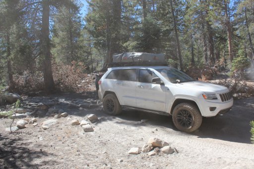

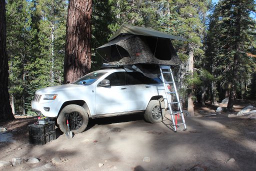

After returning we started breaking down camp and this is when I noticed that my rig was nose up! The rear suspension was all the way in what looked like Park mode. In this photo you can see what I'm talking about. This may have been the reason I got hung up the night before. I know it didn't happen overnight because I would've been rolling towards the back of the Jeep in my sleep.
Crap! How am I supposed to drag my butt back over all that stuff to get out of here!" Don't know but here goes...CLANK! SCREEEECH! CONK! Haha. Pulled over real quick and had a thought to check the compressor fuse. Didn't see anything wrong with it, but switched it with the AC fuse of same amperage just in case. Hit the height adjustment buttons on the console...Nothing. Buddy also mentioned that I should air up the tires to at least gain a little more clearance. Did so and back on the road. And no lie, within a few minutes I don't feel like I'm sagging anymore. I get out and low and behold I'm sky high back there compared to before. What the heck! Don't think it was the fuse because AC still worked. If anyone's got any ideas, please chime in.

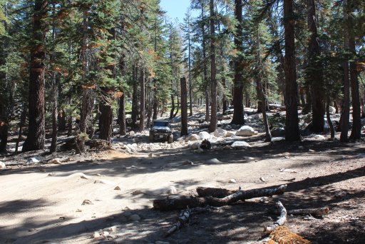

And just like that, I'm back in business. Here's a few shots on the way back out.
The trail to Strawberry Lake passes West Lake. We decide to check out West Lake first. This trail isn't nearly as bad as Red Lake. Actually managed a few shots of yours truly.

Just wanted to add a quick note regarding the rear suspension issue in case any other WK2 guys with QL happen upon this. We figured out what happened thanks to a fellow WK2 owner on FB. When I got high centered, I used my Hi-Lift during the recovery. Before that I did remember to put the vehicle into tire jack mode. But...I did not know you have to drive the vehicle over 5mph to return the air suspension back to normal operation. As the last sentence in the quote from the manual states:
"To assist with changing a spare tire, the Quadra-Lift air suspension system has a feature which allows the automatic leveling to be disabled. Press and hold both the "Up" and "Down" buttons simultaneously between 5 and 10 seconds, a message will appear in the EVIC stating leveling has been disabled immediately after both buttons have been released. Refer to "Electronic Vehicle Information Center (EVIC)" in "Understanding Your Instrument Panel" for further information. Driving the vehicle over 5 mph (8 km/h) will return the air suspension to normal operation."
Since the terrain was so rocky in that area, I guess I never got over 5mph. And when we finally hit a clearing to go a little faster, that's when the suspension returned to normal. So the vehicle was operating as it should. It was just user error. Sort of.
