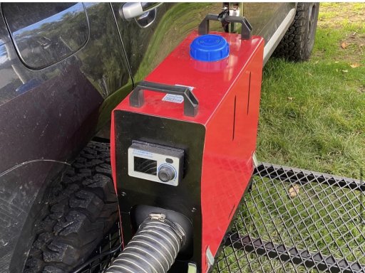

Personally I like the idea of a 12v electric blanket, BUT, The energy costs must not make it worth it or one would see more use of them. I would opt for one of those cheap Chinese diesel or petrol heaters in a stand alone configuration.
Something like this;

Cost wise, an Amazon Chinese diesel heater gives you a lot of bang for the buck. Especially if you already have a diesel vehicle.
I agree 100%! There are some pieces of kit that are considered "game changers", imho- a diesel heater is one of them! I'd buy a diesel heater before a 12v fridge, before a discada, before a smokeless fire pit, and even before a roof top tent! I have acquired all of those pieces of kit and believe each of them bring A LOT to the table! Roughing it for deer camp or scout camp is one thing, and I have gotten by with little more than a good old Coleman Stove and a sleeping bag, but the Wife won't... A dry, warm, comfortable night's sleep is a MUST, if I want the pleasure of her company in the wilds... Nuff said.
