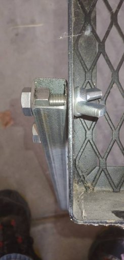

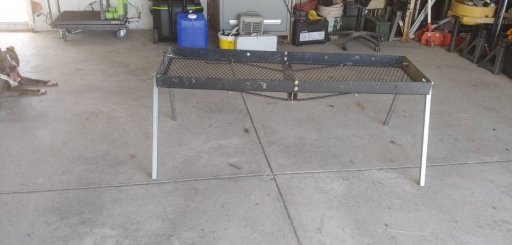

Here's what I came up with. Used 1/2 bolts they fit in the tire down hole the best. Legs are 24" good hieght so I can sit in my camp chair and access it. Thank you for all the input, it all helped me out a lot.0912181254a.jpeg0912181254.jpeg0912181253.jpeg0912181317.jpeg

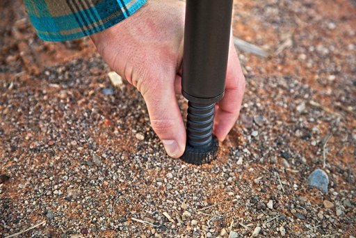

Whatever design you use, I'd probably want a way to level the legs for uneven ground. Perhaps...
View attachment 68028View attachment 68029
Not trying to hijack - but I definitely need a set of those levelers.
Back on subject - if you can weld, a piece of tubing on each corner and corresponding tubes that fit in would be the ticket -- then use those levelers on them :)

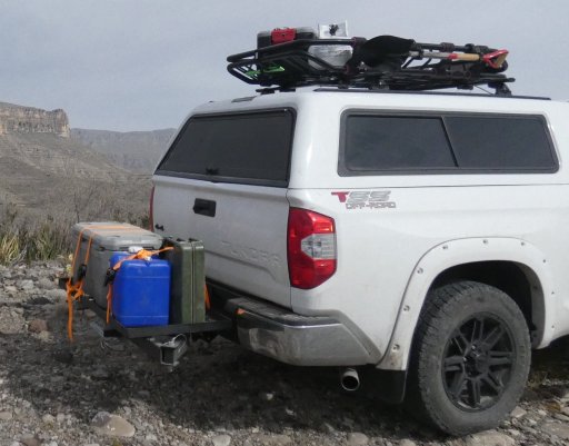

old post, but for anyone who likes the hitch mount cargo rack, get one that swings out and it can be used as a table, etc without having to remove it from the receiver. i use mine with a deck system i built for the tundra and i swing the rack away, drop the tailgate and i have a work area next to me as well as the ice chest right next to me as i cook on the tailgate. quick and easy with nothing to move or set up. i bought the swing-away carrier new for $300....
they are pretty heavy to use as a portable table. i guess if i had to mount legs, i would use 1/2" pipe flanges screwed at the corners and then use threaded pipe as the legs so i could remove them easily and store the legs behind the seat or somewhere out of the way...
