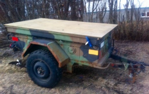

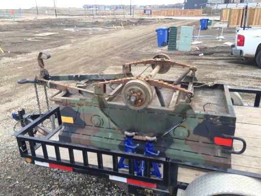

This is some pics of the trailer as it sat when we bought it.
Here is the day we picked it up and hauling it home. Was happy to get my hands on one.

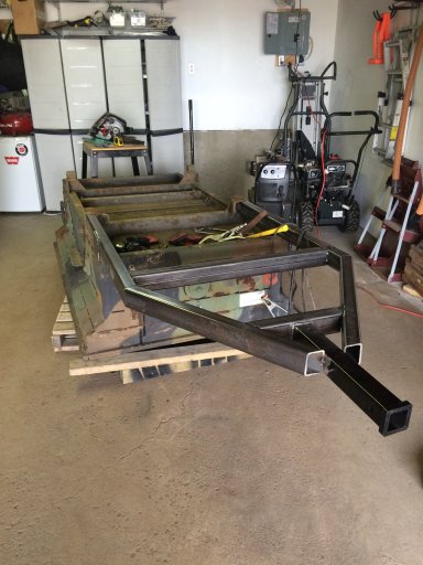

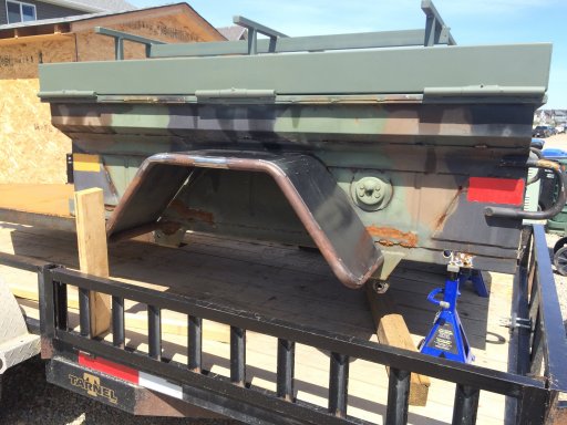

It was a complete tear down.
Had a lot of help from a friend with the tongue build at his place.

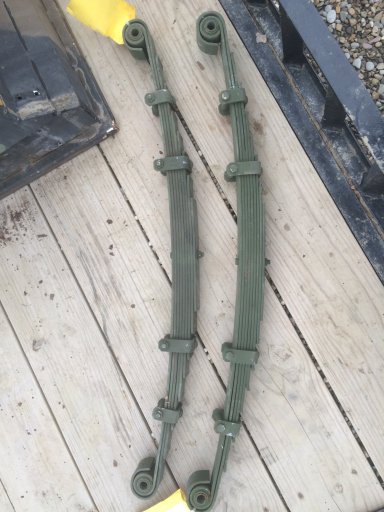

Replaced the bushing for the leaf springs and found some new military surplus leafs for it since the ones on it were shot.

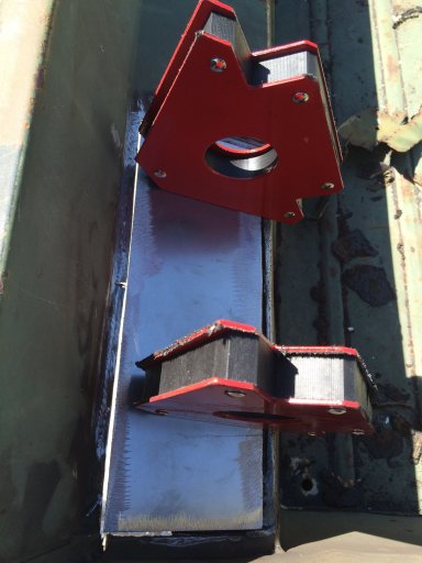

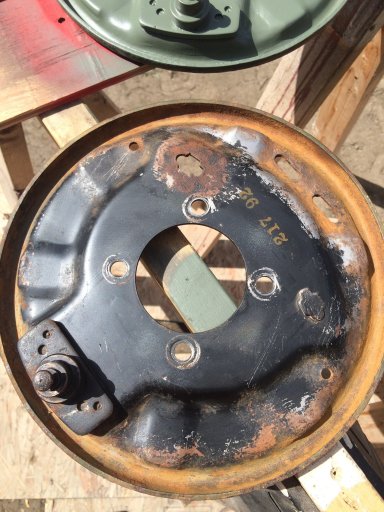

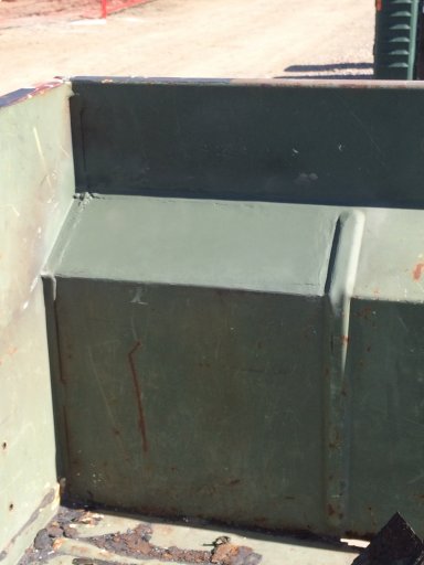

Had a few rusted areas that I had to cut out and weld in new metal. Wasn't bad but just time consuming.

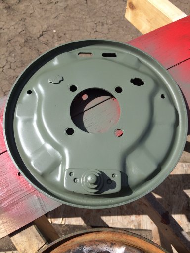

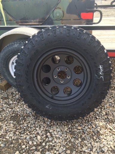

Replace the factory drums with new ones so they had the same 5 on 5 bolt pattern as my jeep.

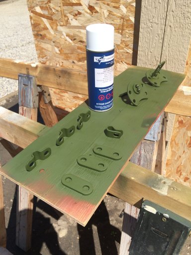

Cleaned up all the parts one by one and repainted them the original military green paint.

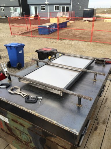

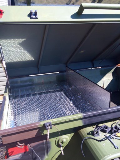

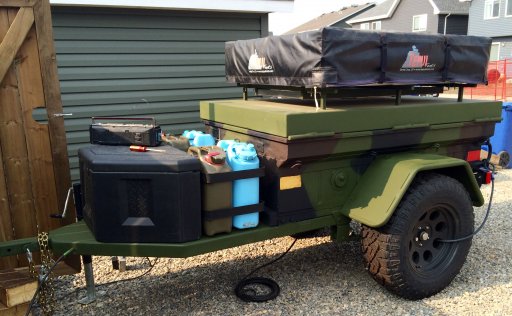

I had a local shop build a lid for me since it was beyond the scope of my abilities. They also fabbed up some new fenders so that the tires would be completely covered.
I attached some rails on the bottom side of the tent cross members so I could slide my table top up in there.
New Procomp wheels and 33" Duratrac tires to go on the trailer.

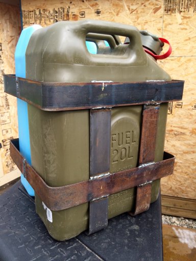

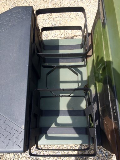

Welded up some baskets to hold my Scepter has and water cans on the tongue as well as a 10lb propane tank.

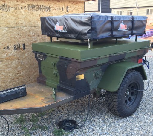

Started getting it together now. Repainted the camo pattern on for a temporary fix until I have everything just right and I will have it Line X'd military green.

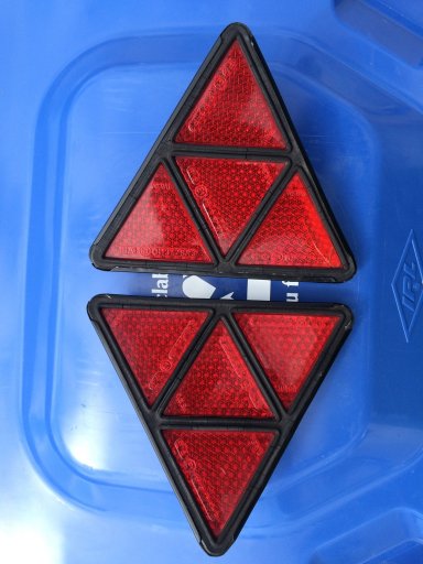

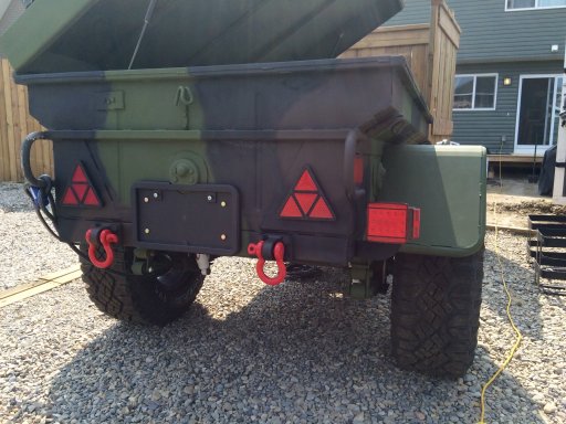

Fixed up the triangle reflectors since they were bent up and in need of new paint.

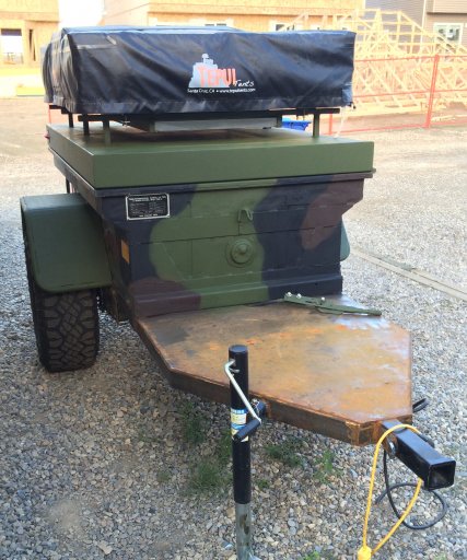

Cleaned up and straightened the original plate for it. The front of the box was bent some so it had to be straightened up as well.

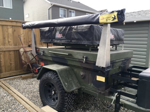

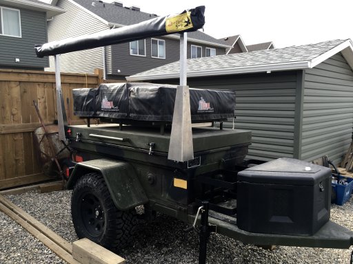

Coming together, tongue box on, table figured out to mount on gender and wiring done.

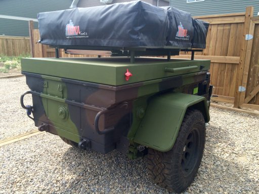

I built a tray to overtop of the spare tire to better utilize the room and it worked out good! In able to put a lot of stuff there and it doesn't go anywhere.

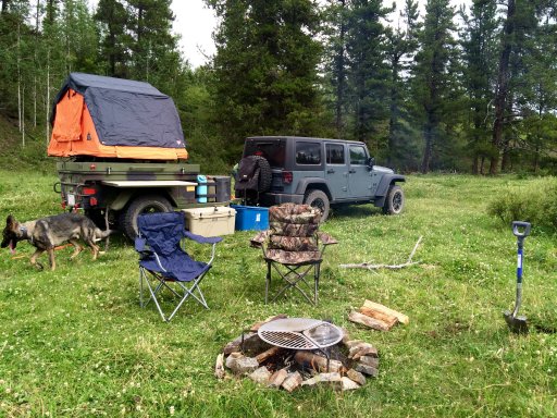

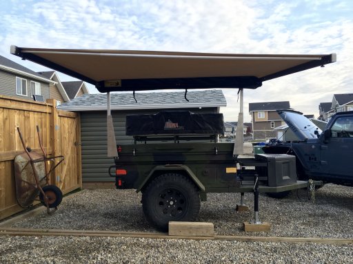

First test run with it last summer! Worked out great just a few minor things to change and add on.

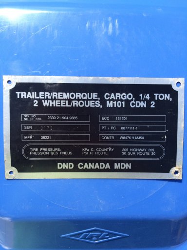

It's a M101 CDN 2 so the smaller version built for the Canadian Military. Really sought after for these builds since they are so tough. Made to parachute out of a Hercules plane actually....

The M101 CDN is the Canadian military version of the US M416 1/4 ton trailer pulled behind GPs (Jeeps). The US M101 is a 3/4 ton trailer pulled behind 3/4 ton or larger military trucks. The M101A3 is its 1 ton bigger brother used behind HMMWVs (Hum-Vees).
