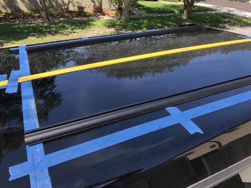

After looking around and considering different options, I ended up ordered the Rhino HD roof rack from amazon. I am extremely pleased with it so far. It seems to be versatile and very well made. I think that for $375-ish I made the right choice.
The install went pretty smoothly. It is a little nerve racking to drill so many holes in the topper. Scary. The install is pretty straight forward. Having a second person to help with the layout and double checking measurements are even on each side would have sped up the process significantly. Total install time was about 2.5 hours. Of course the instructions state the install time as a half hour just to make you feel good about yourself.97617

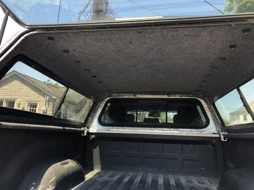

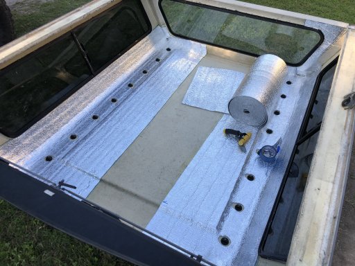

I finally got around to insulating and carpeting the topper. Everything went pretty smoothly. I ran out of carpet and was roaring in the sun but I am happy with the results. 5C574BB4-E1B1-48E1-BEDB-80BE3481825A.jpegCAF690A0-3C05-40F4-973F-D60897D920FA.jpeg349B609D-5284-44C2-990D-FACBD2B5A9B8.jpeg49E74BDE-221A-4EA5-B6E1-6F03CD8A0A36.jpeg408C7A4A-9C3A-484B-97CE-4C9C4DE044E7.jpeg1405A16C-BBBE-4F86-BD9E-72CF7BC4C07F.jpeg

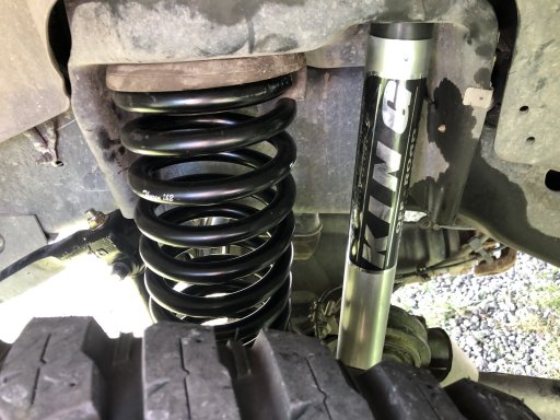

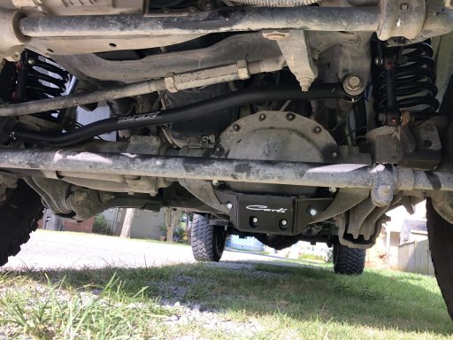

Some progress on the build. Thuren front coils, front and rear trac bars, sway bar end links and King shocks all installed. The springs leveled the truck out pretty well. I now have 1” rake from back to front. The back is sitting at 44 3/4” and the front is now 43 3/4”.
Carli diff guard installed on front differential. Purple Cranium diff guard installed out back. I wanted to change over to a synthetic winch line.
We fabricated a bracket to mount the new Warn Epic hawse fairlead. It turned out pretty good. The cut out in the bumper is a little small for the Smitty Built shackle thimble so I’ll have to figure out how to widen it a bit to accommodate it. Pulling the rope to do the initial pre loaded wrap was so much easier. I think I am going to like the synthetic.
The truck seems to handle better in the corners already. I have only driven it a few miles before leaving town. It takes bumps much easier. The Kings are a big improvement over stock. I will do a more in depth review once I get some good seat time and everything has settled in.
