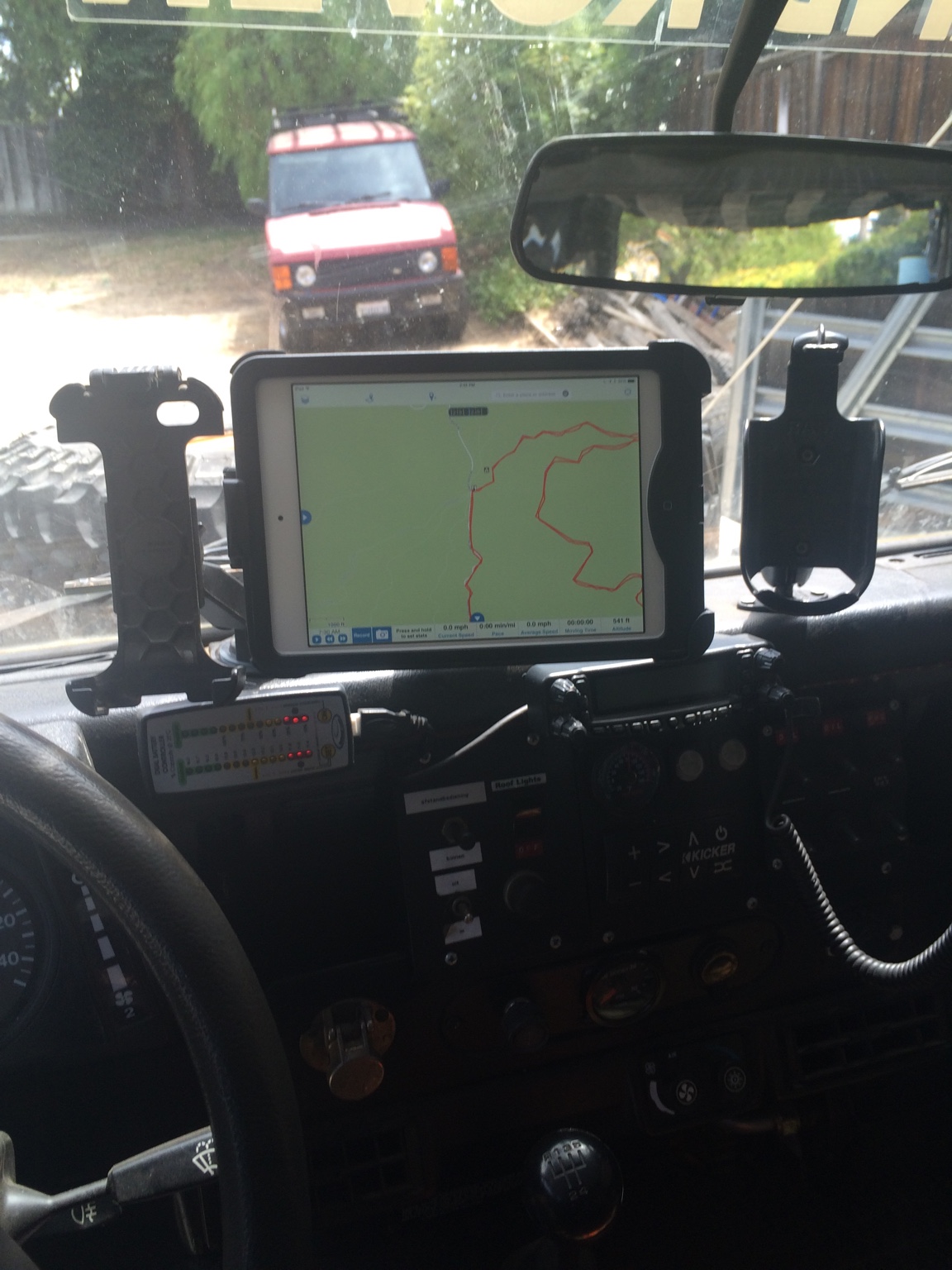

Gaia GPS is the way to go as long as your iPad has a GPS chip (if you can get cellular data it has a GPS chip). If not and it has Bluetooth you can get a GPS puck (like bad elf unit). Here's a screen shot from my iPhone from one of my trips. I use my iPad in the truck.
