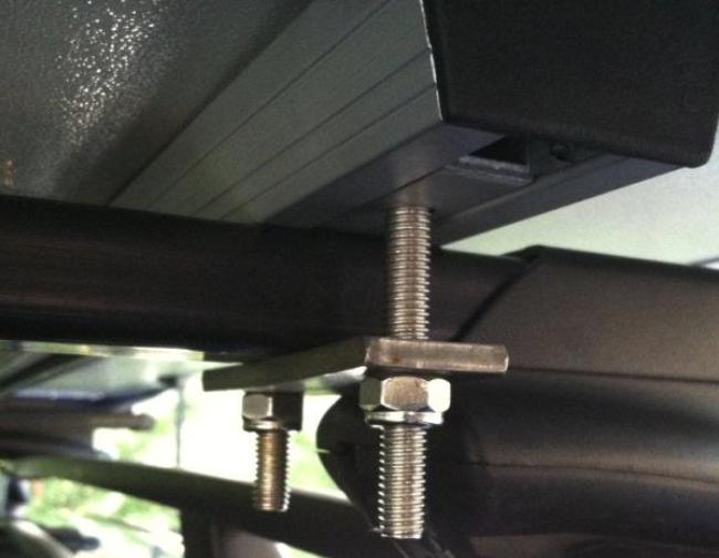

These tracks can be mounted in either direction (across the tent or along it) and they hold aluminum brackets captive. The brackets can slide in and out to accommodate any roof rack that is at least XX inches wide. Since the Kukenam fits on my 54" Gobi, there's no reason it won't fit on your 45" Gobi, as you can just slide the brackets closer together. The brackets then tighten down like a clamp onto the bar rails, like this:
Photo Credit - Tough Stuff
