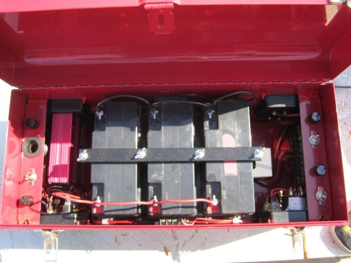

Base camp kit, 3 18ah batteries, 12vdc, 6vdc, and 100 watt VAC inverter (built in hardware store tool box)

I started out playing with a 45 watt Harbor freight kit. The controller was basic and the three 15 watt panels worked fine. Once I got familiar, I built the small emeergency box. When that was done I was ready to engineer this large setup. I worked from the load I wanted to handle outward. Determined battery size first, then controller size, and so on. It's been well over 10 years since I built the box. Unfortunately it was kinda a scavengers parts list. I was originally going to use ammo cans, but the batteries I decided on didn't fit what I had. From what I remember:
Toolbox- Ace Hardware
Batteries- 18amp hour SLA, x3 (was contracting for an alarm company, they rotate batteries on alarms and I was able to get this kind free for quite a few years)
Battery holder- home made with scrap wood from friends cabinet shop
Charge Controller- main one is a 6 amp Sunsaver with Low Voltage Disconnect, and the second I believe is a 4 amp Sunsaver (e-bay)
Inverter- e-bay, out of a decommissioned police car, 100W
6 volt power supply- e-Bay
Battery and Solar volt meters- e-Bay
Terminal blocks, micro switches, and banana plugs and sockets- gift from work when they where closing the plant.
Hardware, other switches, shrink tubing, wire, electrical terminals, etc.- Ace Hardware
The rest- Radio Shack. I struggled to find a plug system and did have my heart set on the recessed panels. I looked everywhere to find something, and found banana jacks/sockets (for incoming power) 1/4 inch Mono audio jacks/sockets (for lights and other accessories), and audio builder components including the recessed plates. At the time my local Radio Shack was well stocked and happy to let me go bin surfing to find what I could use. I also use speaker wire for all cords.
Anak- For the recessed plates, search Amazon, e-bay, or the like for Audio components for building speaker boxes or subwoofer boxes. Search words such as "Speaker Input Plate Blank", "Terminal Cup", or "Audio Jack Plate" will turn up a selection and give you more ideas for search keywords. Yes, I miss Radio Shack! The recessed plates allowed for throwing the box in the back of the truck or the like without damage or snagging of the components on other gear. If I broke one now I would play hell finding the right sized replacement.
A note on Solar panels- I purposly went for amorphus panels, rather than crystalline. The amorphus will charge with indirect sunlight, so even on a hazy or overcast day I can charge. The efficiency isn't as good, but crystalline take direct light only and living within the marine influence overcast days can be the norm here.
Now fast forward to today. The box is heavy! I wish I would have gone with my original idea, which was the panels, a small junction box, cable, a battery box, cable, and then a power distribution box. When camping in the Sierras, usually camp is under trees and having the main box in the center of camp and running a lot of cord to the panels just becomes an excercise in compromise. It would be nice to have the batteries in between the panels and camp table, with a kicker cord to the tent, and just a distribution box on the camp table. Plus the box is pretty heavy with the 3 batteries (after injuries and age, I'm not 20 anymore...).
