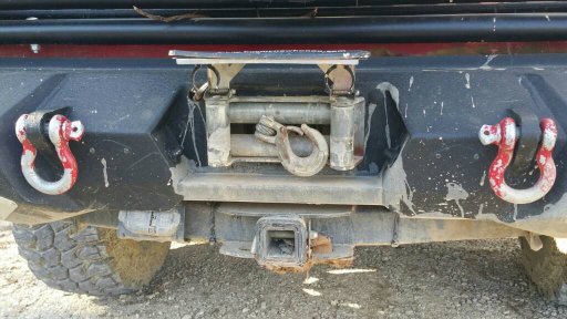

Looks great. I like the no nonsense approach but I think you will soon learn that you are never done. [emoji16] Did you happen to make the rear bumper as well? I like the rear winch hiding in there.

Front bumper is trail ready. Rear bumper is a smittybilt. We cut the tag area out to fit the winch.20190310_164120(0).jpeg

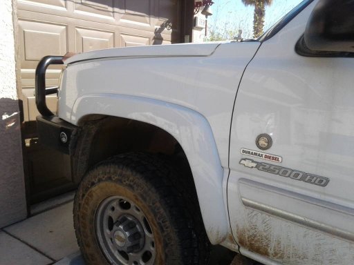

How do you feel about the cut out fender flares?
Frankly I am disappointed. I smashed the right rear against a tree and the fender flair is now toast. So I am removing the pickup bed altogether and putting on a flatbed.
The flairs look good and if you don't leave pavement will last years but they are a commitment since you are cutting the walls you cant go back to stock. For the price and commitment I would like them to take some abuse. They are hard abs plastic so they break instead of flex.
Well that’s disappointing to hear. Was playing with the idea of getting some to fit some larger tires under my truck with a level but the majority of my driving would be gravel roads/ farm roads so probably wouldn’t hold up very well. Thanks for the info though.
Gravel wont hurt them.
