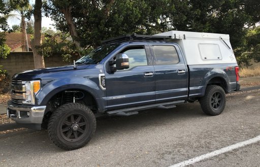

69machguy
I finally got my Carli lift installed, their 2.5" pintop system. This allows slightly bigger tires at some point. I did the Range Rover driving course at OE West in Flagstaff and had no issues ... though it was pretty tame. I'll take some better action shots next trail ride.

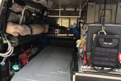

69machguy
This was how I packed for a recent road trip. I have a 10 gallon pressurized water tank (Roadshower.com), which I use as a kitchen. If I'm traveling solo my air mattress fits the cab floor, breaks down easy, and is super comfortable. If I'm with a group I deploy the Habitat camper. The cabinetry is a Goose Gear system with drawers, and my chuck box and fridge are both on slides. It's ~90% complete, always a work in progress ...

Highest possible recommendation, as this is also my daily city driver. View attachment 101501View attachment 101502
That is super nice looking! Which canopy did you get? what rack system are you running?
69machguy
I recently had a local Encinitas shop (SoCal Custom Audio) do custom fabrication for my truck. In the pic you can see new cabinetry at the top for loose stuff, a small rack below holding my roof rack ladder and recovery bag, and custom CNC gussets for my Roadshower unit. This all helps with organization and keeps the truck bed floor completely free for sleeping.
