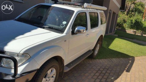

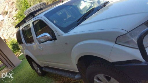

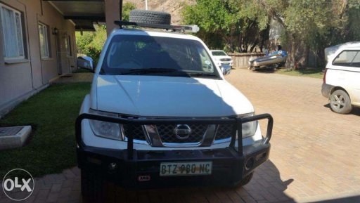

I came across these online. It has the Slimline I on it, not the Slimline II. However, the mounting system is the same.
1000544079_1_1000x700_nissan-pathfinder-4lt-4-4-upington.jpg 1000544079_2_1000x700_nissan-pathfinder-4lt-4-4-upload-photos.jpg 1000544079_3_1000x700_nissan-pathfinder-4lt-4-4-other.jpg

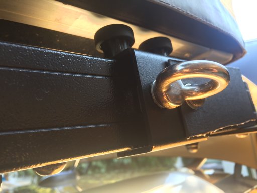

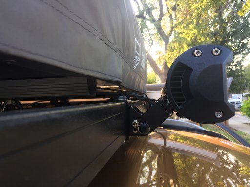

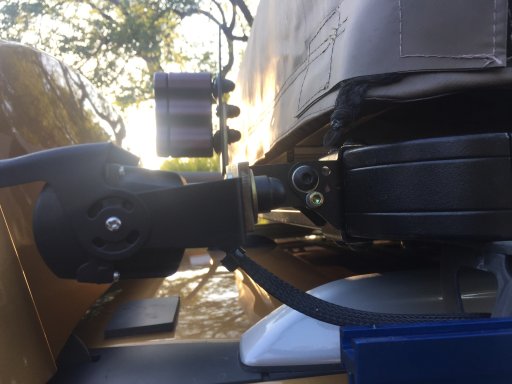

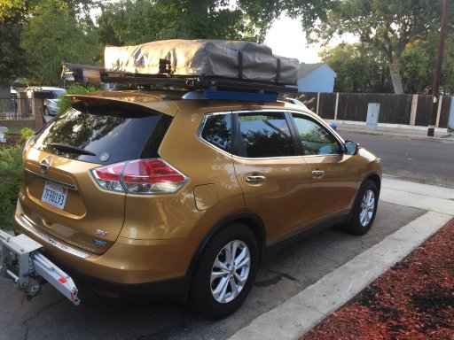

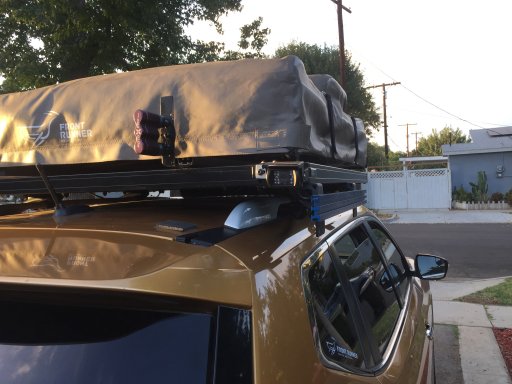

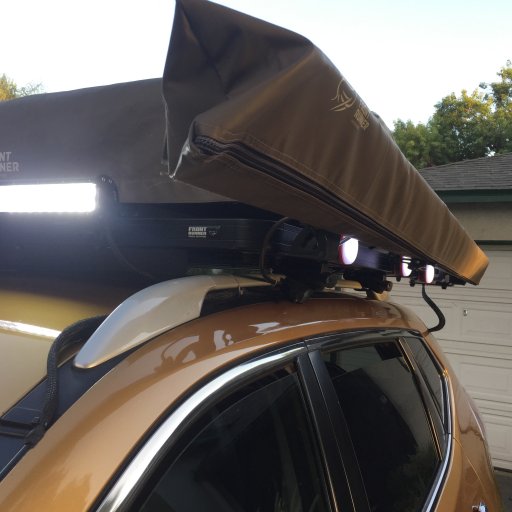

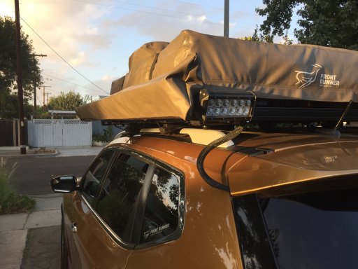

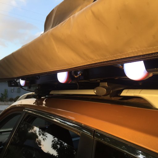

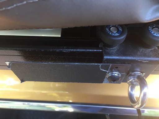

So I thought I post close up of the mounting systems for the rack. The awning lights are on standard accessory mounts. I modified these with T bolts and thumb knobs so I can slide them over the length of the rack. I added eye hooks to mount light rope across the length of the awning that will support hanging LED lights. There are two additional mounts for the rear lane change camera and front light bar. IMG_1629.JPG IMG_1632.JPG IMG_1635.JPG IMG_1638.JPG

Could you post a close up photo of where the front runner is mounted to your roof rails. Awesome lights by the way; I really like those

Nice use of the Rockler Pucks!
