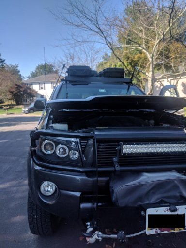

I have a system that ties in to the oem nav/backup screen, really helps when off road. I have seen other add on systems with screen and two cameras for front and rear vision.
You can see the camera just above the winch, below the light bar.
