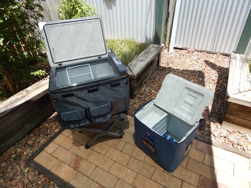

right been looking at the following thought id ask you lot down under
Iron man
Arb
Waco
Thinking about 40 ltr Any info. Thoughts.

I have ARB 47 litre and works great. Touch wood.
I actually use the fridge everyday. I cannot see why I need to run a house fridge when I only have a bottle of milk, butter and some steaks/sausages in the fridge.
I was looking at one of the Bushman 35, 42, 45 and 52 litres in one fridges.

Dometic/Waeco makes the ARB fridge.
Been very happy with mine.
Think we get the old models over here lol There are a few availible theres a cooler aluminium its a good price but its only a cooler. I am only running a single battery at the moment But the iron man option has a setting to overcome this do you know anything about them

Hi,
I have two fridges. One is a 15 year old Waeco 45lt in the Jeep and the other a Primus 65lt dual zone in the camper. The Waeco has been a good performer but uses a bit more power with its age. The Primus is great for its flexibility as it can be set to two fridges, fridge and freezer or two freezers.

I have an ironman and its good, it is just an old model Waceo anyway. Draws a bit more power then say an engel but for the price at the time it was the best value. I would go Engel first the ARB then Waceo then Ironman in choice.
Interesting ill look for engles now

I have a 50L National Luna, it's a divided fridge freezer but can be run as a freezer and deep freezer too.
It has a small footprint - I have it in a 40L fridge MSA drop slide.
Running constantly (in landcruiser or in house) for the past few years
Recommended

I have a 40lt ARB permanently in the Jeep and has been good to me. I also have a 95lt Waeco which I now use as a 2nd fridge in the house and also have a 60lt Evakool in my Patriot camper. The Waeco used to travel in my box trailer when out camping before we got the Patriot. One of the cool things (excuse the pun) about the Evakool's is that if they ever stuff up you can always use them as an esky due to their inner construction and the fact the motor sits outside. The box compartment itself is essential an esky which will keep you beer cold for days if filled with ice :)

I think most of the major brands are going to work just fine, but for me the think to look at is just how it fits where you want to put it and how it opens up. They all seem to have different lids and latches and such. Depending on how you plan to access it, the lid seems like the most important thing to choose. I personally prefer the ease of opening and closing the ARB. I also like how easy the entire lid pops off, but I don't usually have to remove it.
