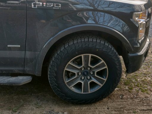

If you go 33s do you gotta change wheels?
The size that I run are 33s on the original rim (see photo). You will have to look up your rim though, there are differences in the width. Maybe yours is a bit wider than mine and you can run a wider tire.
