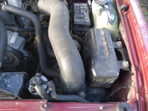

Hey thanks for the info. I have seen the slee one Before. The problem is I have the 91 and my battery is already on the left. The 93 when they changed the motor they moved the battery to the right side. On mine I have a fan of soom sort that blows air on the Motor when I shut the truck off some times. So I can't move the battery to the right side. It's an odd problem. I will post pics of my fix when I get it done

The black tube is where the fan blows air on the motor and some smog control stuff sits
Hey look at that! Neat never seen that configuration. I would run an isolator from your battery find a place in the back behind the interior panels that you can hid an optima or something else that you can mount any direction you want. Good source for 4 gauge wire is 4/GA jumper cables from amazon you can get 25' length for your Hot and have plenty of black to chop up for grounds.
