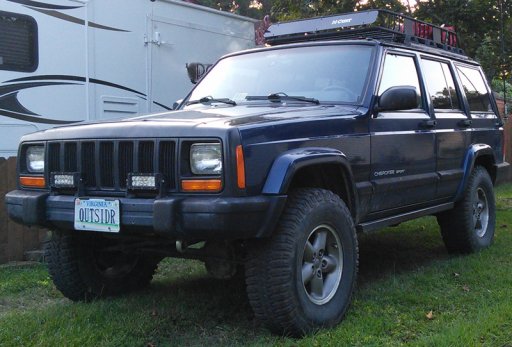

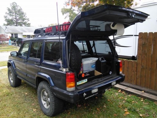

96-99 Jeep Cherokee. Cheap, light, small but roomy, TONS of info on almost every issue you might have, parts new and used are plentiful and cheap, and they are quite capable even in stock trim. Stay away from the 00-01s. Despite being the newest, they seem to have the most issues. Since they're unibody, find one with as little rust as possible. JeepForum was a fantastic resource for info and ideas when I had my XJ. And definitely get the 4.0 engine. Other engines were available at different times, but the 4.0 was best at power, fuel economy, and durability.

I think C4x4 front hooks were the first mod I made to my XJ, followed quickly by a rear receiver. More than anything else, sturdy recovery points are a must before you ever venture off the beaten path.

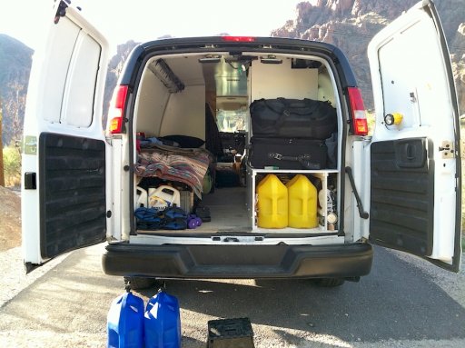

I've used long wheelbase RWD vans (more about that w/pics in my intro here: http://bit.ly/2vVCR6S) to go all sorts of places regular RWD vehicles can't. Jeep trails in Death Valley. High-clearance only roads in Big Bend, etc. You get a lot more room inside a van to grow with, even in a reg wheelbase van, and a much more variable space that allows a wider variety of usage.

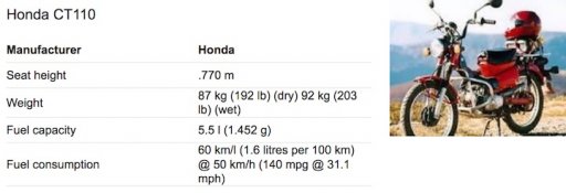

The Honda CT110 you're thinking about weighs between 190-200 lbs and will take up more room than you might think if storing it inside any vehicle, along with fuel can, never mind how difficult it might be to continually load and unload something that weighs 190 lbs.

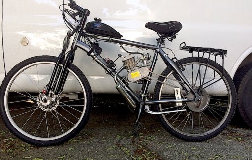

I really want a powered bike of some sort too, to tool around, go fishing, photo-op spots, get provisions, etc if my van and trailer are set up as base camp. Much more efficient transport, too, for short trips. So I bought a newly motorized used mountain bike; two-cycle engine, chain driven, only 40lbs, maybe, and way easy to lift in and out of my van or onto a rack. Here it is:
Kinda noisy in the back country if you're trying to observe wildlife or not bother anyone else, and, at least in the configuration above, really bothered my old wrists to ride, even over smooth terrain. Only had one pedal speed, too, and you have to work against the engine when its off. Was starting to work on different handlebar arrangements, padded gloves, fenders, and the old-style shock forks in the pic, to alleviate the wrist problem.
