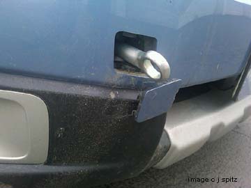

So I'm trying to determine on the outback if I would be better served using the front and rear factory tow points as a recovery spot and or to pull others out of a spot or if I should put a d ring in the trailer hitch reciever and use that at least as a rear tow point? Should I use one or the other on the rear or is it a moot point?

I would go with the hitch receiver and a D ring in the rear. Most factory tow points are really tie down points for shipment and towing. As for your front I could not help you with a suggestion.

Does your Outback have the two hoops up front and one at the back? Those are tie down points. You might get a few straight pulls on them but you won't get away with doing a hairy recovery. Our Forester is the same. Worse if you have the 'tow bolt' that threads into the bumper..
Your options are pretty limited, a shackle hitch is going to be your best bet. Problem with Subarus is there are no frames to bolt recovery points to.

The confusion here is that we are talking about recovery points when really the car only has tie down shipping or straight/flat/easy/tow points;
:flushed:
Bingo. I have one in the front and one in the back like is pictured on the top picture.

I would rather have a hitch point mounted for recovery than any of those in the picture. Even a unibody will displace a hitch being pulled on.

I would say get a shackle kit for your hitch. They are about $60 and can take a good yank. The standard "screw in" tow ring is really only made for pulling the vehicle on flat ground, with freely moving wheels or winching it up onto a flat bed, might become a projectile if you try to yank/get yanked out of say some mud or deep snow.
I have to agree with Big E. Those little front screw mounted tow loops would probably work to help get you unstuck from some very mild sand and mud, but if you were buried up to the axles, there is no way that thing is holding up. I would trust a hitch that more than likely has 4 points that it is bolted to, than a front tow loop.

People keep saying "rated" recovery points, loops, and shackles. However, the OP only mentioned factory towing loops on his unibody crossover.
If the OP does not actually have "rated" loops, which he likely doesn't if they are factory, then a Class III hitch with a shackle mount should be a far safer option.
