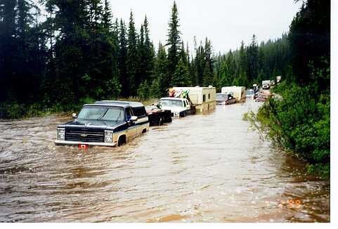

Funny story. Many moons ago when I was young and foolish I was bush camping in the wilds of western Alberta when it rained. And rained. And rained. On the way out, I had to contend with a creek that had jumped the road.
I’m in a 2 wheel drive 87 Chevy, and with a ton of people so we went for it.
We made it. My carpet was a little wet but no big deal. No one had done any breather moving on differentials and transmissions and we all got out just fine.
On a somewhat potentially related note, I did have to replace the transmission 2 months later. In retrospect a little bit of fluid changing would have been a good idea. Did the water cause it? Maybe. It probably didn’t help. No one else had any issues but who knows.
So I’d say your chances of making it through are good. Ill effects may be nil. But... you never know.

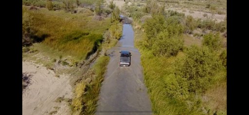

I hadn’t found that in my research. I ended up driving through it and it seemed fine. As a precaution I had the oil changed in both diffs a few months later (it was getting close to the 30k service anyway).
I will add, although I’m hesitant to raise unnecessary anxiety, that a ticking noise appeared afterwards. It was coming from the engine and I presumed it was a belt but couldn’t see anything. It didn’t seem to affect the truck in any way, so I didn’t bother doing anything about it for a long time. Then, over a year later I finally dropped it into a dealer to look at. Turns out the throttle body was bad. I didn’t tell them about the water crossing and I couldn’t say for sure it was related.
Maybe someone smarter than me can comment on whether that cold have been caused by the water crossing.
The water also tore the OEM “skid plates”. The fact it could tore them is an indication how weak they were. They were made of felt. A good excuse to buy the RCI Metalworks full skid plate package!
I actually wrote a blog post last week about all the mods I’ve done to the truck so far. Might be interesting for a fellow F-150 owner.
https://www.adventurousway.com/blog/why-we-love-our-ford-f-150
The main thing is that the water was quite deep and it was crazy good fun to drive through it. We got some killer drone footage!
