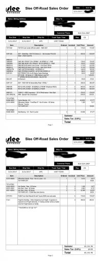

Thanks @rochmpr
I went with the OME 2.5" medium lift and am going to stick to 33" tires since re-gearing it and buying 35s will go over my limit. I think it should be fine for what we will do with that lift. Also getting the center diff lock switch so I can lock it in 4-Hi as well as 4-Lo. Just bought them so no going back now! :-)
