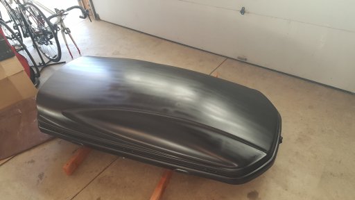

Hey everyone. Here is the result of the face lift. I'm not totally happy with it mainly because of the streaking on the top. At a later date I may throw on several coats of Plastidip. But for $15, I'm fairly happy.
Looks sweet! It's on the top. No one will know those streaks are there except you. Besides take her out into the woods and some low branches will pinstripe them for you! :D
You can still sticker over them with all of the places you go in your truck.

Yes sir. My thoughts exactly! Worse case, I sand it down and go with another medium.
