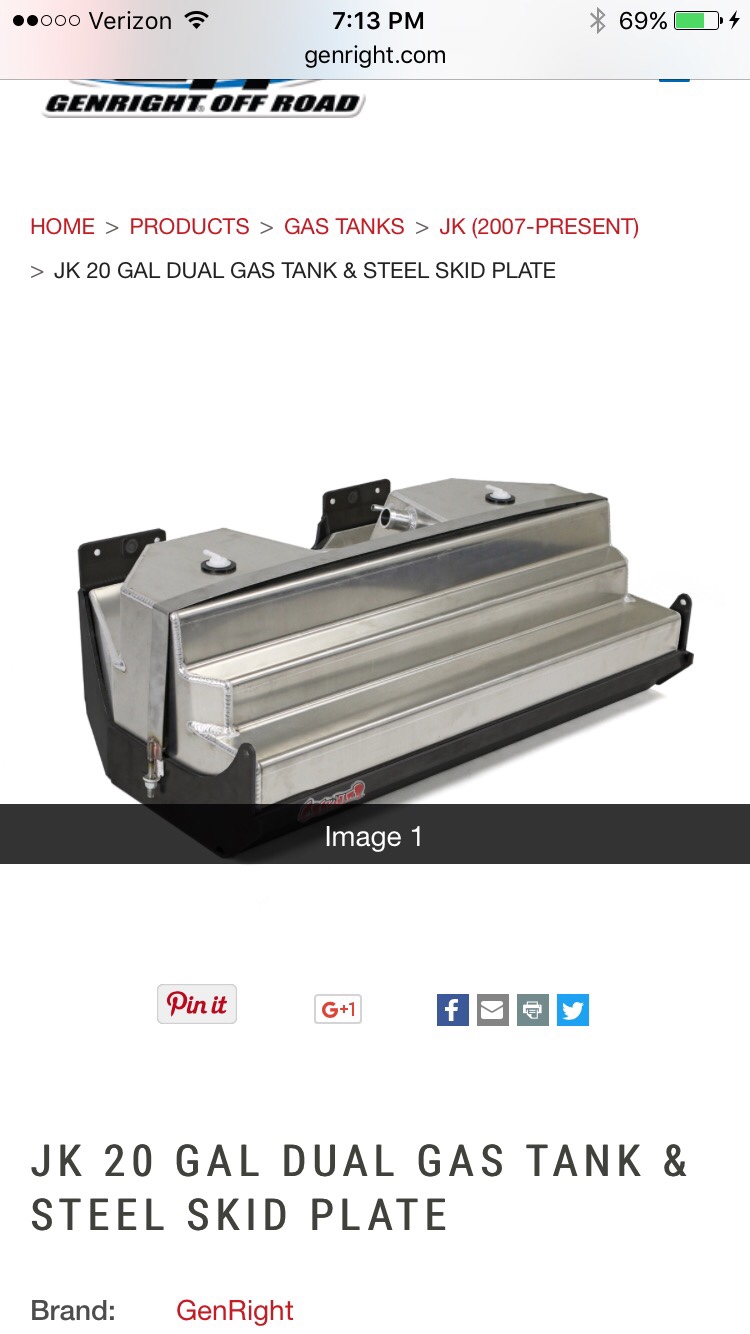

Hey guys curious as to how much extra gallons of gas do you all carry on a weekend or long expedition wouldn't want to be stuck out their with out gas especially with the family. As I was looking on FB earlier a Genright pop up came up with there dual gas tank for Jeeps that from 20gls it bumps it up to 45gls with a 600 mile travel tank of gas. Don't know if it would be worth bumping up the gas tank or just carry the 10-15 gallons extra.
Here's what the dual tank looks like and it would sit towards the rear of the jeep and not interfere with any clearance issues.

What provisions do you have to carry extra fuel now? Where will you be going, and for how long? And, how often do you foresee needing more than 10 gallons of fuel?
While cool to have, I don't think a super extended range fuel tank is needed in the US. If you're going on an expedition in Africa you'd want one for sure. What other parts are needed to install the extra tank, and what's the cost vs. going with Rotopax/Jerry cans?

I'm just starting out with a stock JKU-Rubicon. The tank comes complete with dual fuel pump and switch up on the dash to switch over tanks when needed. As of right now I have nothing yet but will be getting a roof rack, a 2.5"-3.5" lift with either 33" or 35" tires. I'm also in the work of building me an OffRoad trailer to carry gear and stuff for a family of four. This will be kind of a slow build as I'm doing research and asking for info and advice so that I'm on the right track as I'm a newbie to the overland scene. I don't plan on going to Africa anytime soon, but that would be a sweet expedition for sure. I'm talking more along the line like Georgia, North and South Carolina and planing on doing a trip up to the west coast. I'm just trying to plan it right for the wife and boys. Thanks for the info and any advice given much appreciated.

Yea I see what your saying with the weight and all, plus as soon as I saw the price of $1,999.00, I was like yea forget it I'll stick with two Rotopaxs or jerry cans and just mount them on the OffRoad trailer and hopefully if I ever get in that situation I'll have 10 gallons to get me to the nearest gas station. Lol. Thanks guys for the advice and help on this.

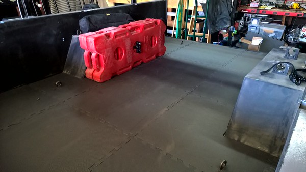

We carry (2) 4 gallon Rotopax on our trailer. While they are a bit pricey, they seem to be very durable, and can be mounted in a variety of ways. Before the trailer, I had them lying flat on the Gobi Rack on my Jeep, much better then 2 5 gal Jerry cans on your roof! No issues with leakage.
How much gas to carry? Well that depends, we make trips into Death Valley where we may be 60 miles from pavement and then another 30 from the nearest station. While we only used a 1/4 or so on the way in, (and didn't explore much) we came across a couple that had broken down in their full size pickup on the way out. This was prior to our trailer, but being that it was over 100 degrees, we certainly couldn't leave them so we ended up towing them to the nearest services. Throw in a mountain pass or two and by the time we hit the gas station (5+ hours later) with them in tow, that 3/4 of a tank was down to fumes. Knowing I had the extra fuel if needed was great piece of mind.

Sadly most of our trips of late have been long weekends! Still I prefer to be a little over prepared, just in case, whether it's for us or to help someone else. I was trying to post a photo of the Rotopax in the trailer but it's not linking for some reason.
I have a very large and slightly long winded trailer build thread on Expedition Portal if you are interested. Hopefully cross forum posting isn't an issue, too many pages to copy to here.

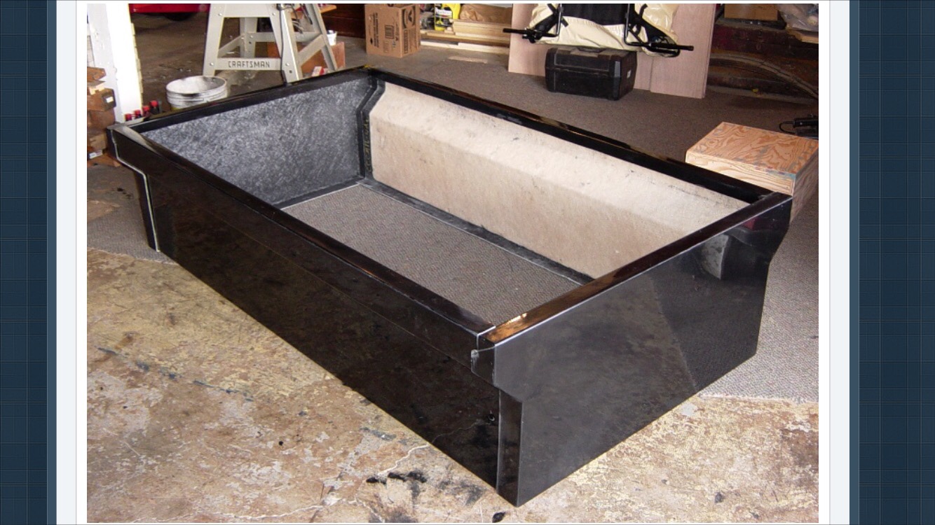

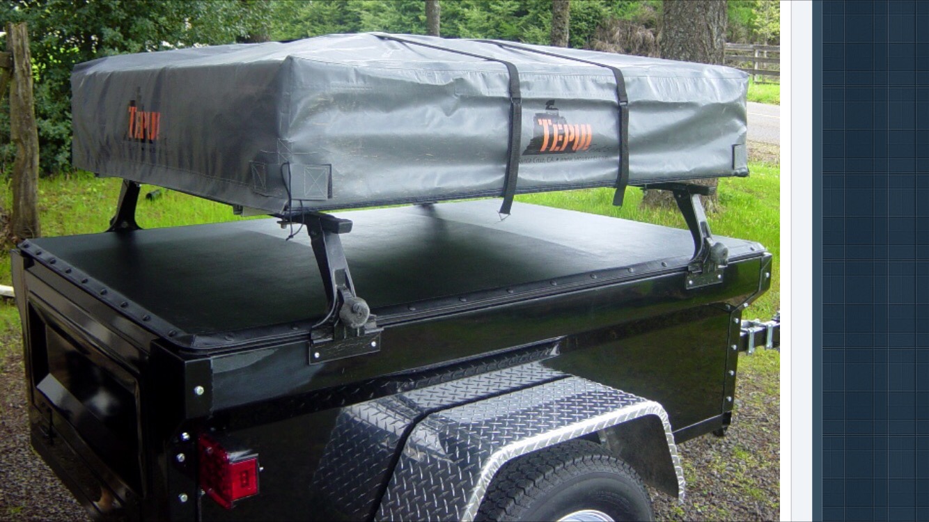

Wow!!! dstock I just saw your build thread what an amazing job you did with that M101, I was looking for one of those for a while here in Florida but it's like they want an arm and a leg for those trailers or the M416 also. So I found this trailer manufacture that's called dinoot and found an M416 tub made out of fiberglass and will be building it off a welded trailer. Here is what it looks like.

Thanks, I got lucky and got a deal on mine but they are getting harder to find for sure.
The Dinoot is great little trailer, the guy who designed it in on Expedition Portal as well. Have fun with the build, I tell you it's totally addicting, not sure I will ever "finish" mine! Ha!
