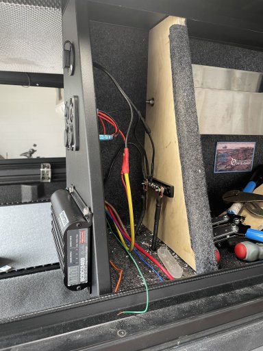

Hi folks. I just thought that I’d just give you my impressions of the Redarc 1240 BCDC controller.
In short it went very well. Now I have to say I am by no means an electrician in fact, I’m an electrical virgin…
Anyway, I had a couple of question about various steps and @REDARC_Ryan WAS ABLE TO GET ME THE ANSWERS QUICKLY. Tahnks!
Here are a few pictures of the install in my Jeep Gladiator with an Alu-Cab canopy in the back…
I HIGHLY RECOMMEND THEIR PRODUCTS AND SUPPORT156E042DD-A8CE-40DD-87F1-7FDF0161E241.jpeg771A92EF-683F-4C8E-BF82-7B1D6807D1FA.jpegE516DDBE-D7D8-45E0-AEEA-4B3090741727.jpegFFE25B65-4158-4975-9B18-2E76123EA9E0.jpeg893715B2-2BD2-48F1-9B26-7EF705665CCB.jpeg62992839-AFBA-496B-8053-329BA1593F0D.jpeg THEIR PRODUCTS AND SUPPORT!
I HIGHLY RECOMMEND THEIR PRODUCTS AND SUPPORT1View attachment 203862View attachment 203863View attachment 203864View attachment 203865View attachment 203866View attachment 203867 THEIR PRODUCTS AND SUPPORT!
It looks great! Now go test it out
Reactions: smlobx and Road
