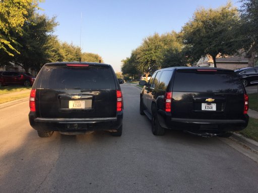

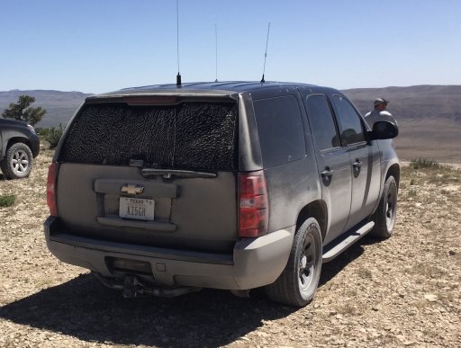

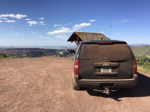

I have an array of options, for my array. I typically mount the dual band on the right side midpoint mount with an NMO style. First pic is a full Larson NMO 2/70. Second is a clone put out by several companies, it’s 1/4 wave on 2m. Last pic, thecopcar on left, is a 4” stubbie. I carry all three and use the one which best fits the use and terrain at the time.

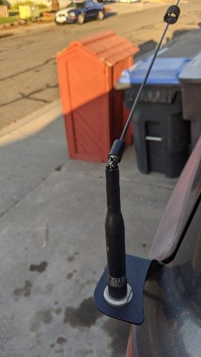

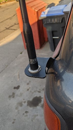

I was looking for the same thing, but had a hard time finding it. I finally settled on this, it's a Comet.
It is not flexible, but it is designed to bend when you pull it straight up and over.
I find this very helpful when I am loading up my kayaks.
