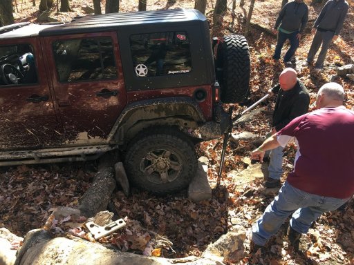

Here are some pics of one of the guys in our group at Rausch Creek who got stuck on a Red trail. The red trails are rated 9 - 10 (hardest at the park). The group was supposed to be doing level 6 trails (blue). The trail we were on crossed this red and one guy wanted to try it. He got to the end but got stuck going over the log. I don't remember all the details of how he was stuck but he was able to cast off the hi jack. As far as I know there was no damage to the jeep and none to the hi jack. Also, I'm not suggesting to anyone that this is a safe and smart way to get unstuck. I'm just sharing some photos of someone actually doing it.

@BigSwole those are some good pics of "casting off" a hi-lift - assuming that their plan is to push it over to one side or the other.
I can't see the foot they are using, I've seen some damage to the jack when the standard foot is used because of the rotation or twist in the jack in relation to the foot.
I have always used the Masdam accessory foot that replaces the original foot to use on hard surfaces. It would sink right in to what they're on there it looks like.
What the OP was thinking about (I think...) is driving off a jack, in other words, in these pics, as soon as they get the rear tires high enough to get over that pesky log, they drive forward (lockers) and that gets them out of trouble.
If I can imagine that, the jack would be pushed in to the rear bumper of the Jeep and damage it considerably.
Not to Monday morning quarterback it, (it is Monday morning :) ), another option would be to stack rocks under the tire to get the Jeep high enough to clear the log.
But in that case, I would use the wheel lift accessory to eliminate the suspension droop.
Dan.

In this case it sounds like one of those wheel adapters would do well, uses the hi lift to jack directly at the axle so you don't waste jack travel cycling through the suspension. I've never used one but it could have come in handy a few times.. we almost took my brother's door glass out last time we used a hi lift. He was stuck in a creek and shifty, wet rocks made for unsafe jacking.. ended up using a winch. Driving off a loaded jack would have to be a worst-case scenario for me, I hope everyone was standing clear away from that jack while this was going on.
