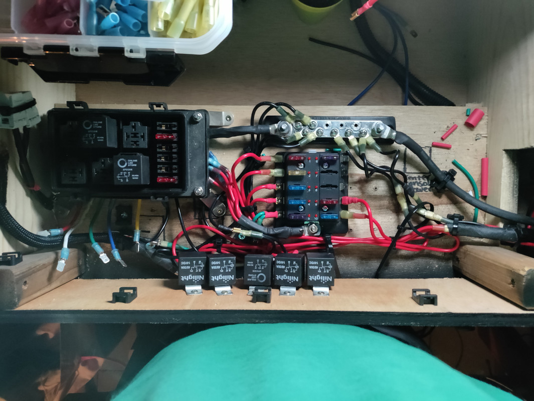

I'd recommend buying a spool of 12ga tinned marine wire (I use wire from Anchor Marine).
Though, if you have to run a wire to the battery, why not run a larger gauge wire to a fuse block so that you have expandability in case you want to add more stuff in the future?
Wiring can be intimidating at first, but once you figure out what you're doing, it's actually pretty easy.
This is what I built in the back of my Xterra, which has worked very well over the past year or so...
