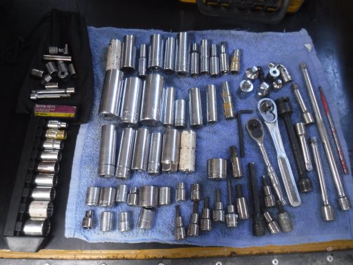

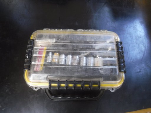

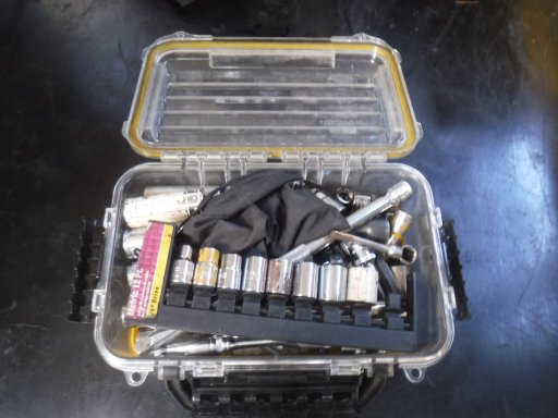

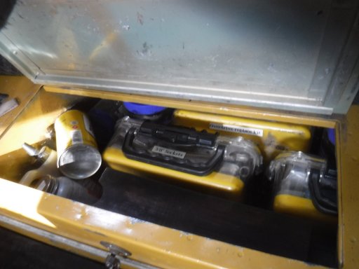

As I stated before I mostly use the 3/8's, I would advise getting the deep sockets, they can fit over the nut ends when you can't fit a spanner. I keep all my 3/8's in a Plano box, that way they don't get wet from condensation, rain, deep puddles or dirty from dusty conditions. I keep my 1/4's in a bag in the same box.
