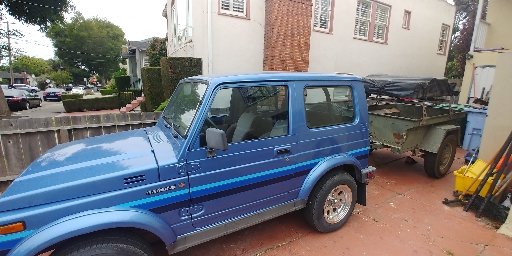

Just keep in mind the max towing capacity for a bone stock Samurai is 1000lbs. Also the stock brakes aren't all that adequate( upgrading soon.). What I did for my setup was to buy an m416 military trailer it weighs 550lbs dry. With tent and fully loaded it weights 775lbs+/-,( and it's still a bit sketchy down hill.) I am about to change to a timbren axel-less suspension to drop weight and get electric brakes, and get better clearance. Can't wait to see what you build.
