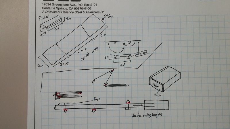

Aight, let’s see if anyone can help with this because I’ve been rattling ideas in my head for a while now with no results. I have a 70lbs (31kg) English Bulldog and due to both of our backs/hips lifting him in and out of the tailgate area was getting old VERY fast. I looked into a dog ramp and got on off craigslist, and after a week of training he was a pro and going up and down it.
The ramp is a tri fold ramp and folds up nicely with room to spare for the pup.
So what I need. I still have to lift the ramp out and set it up each time and wanted to see if anyone had ideas so that it could be made to unfold more easily upon opening the tailgate. See photos below for current set up. I would like to maybe get to the point when I open the tail gate up and the ramp comes out automatically.

i was thinking a telescoping ramp that stores in a drawer in the bed of the jeep. They aren't cheap though

when i fold the ramp up. it sits right next to where my pup is sitting. So i could either build a drawer system that covers the entire trunk area, or just one the the right side of it.

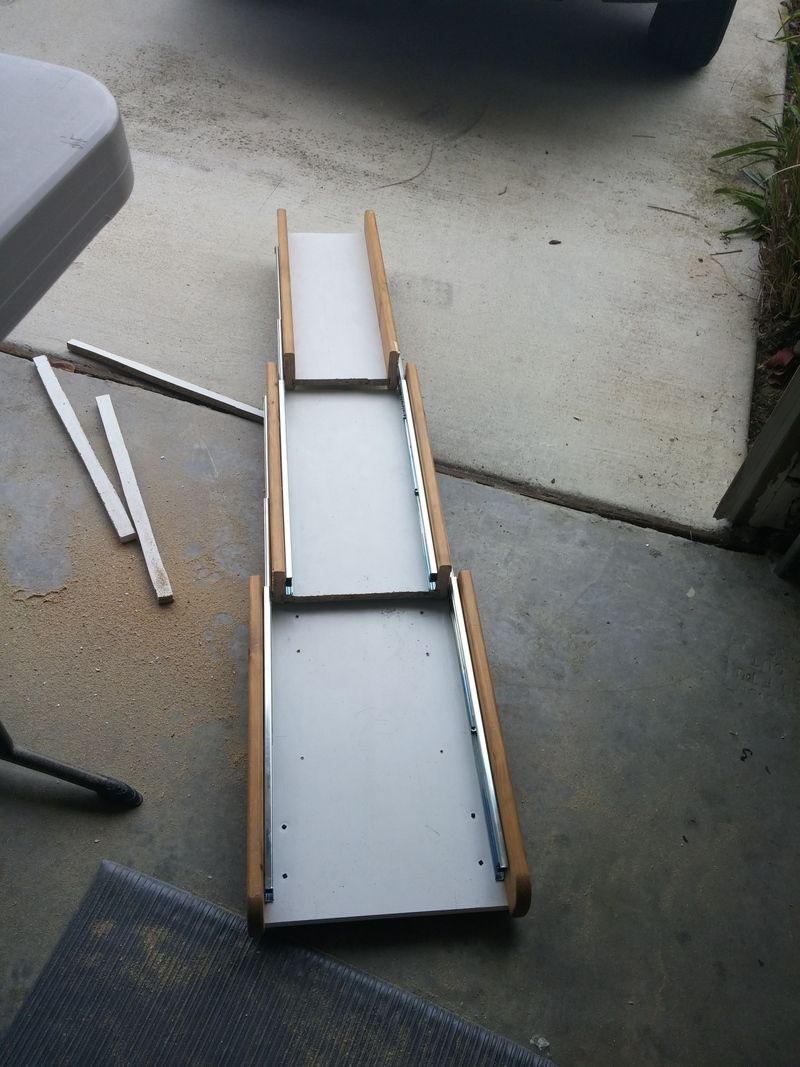

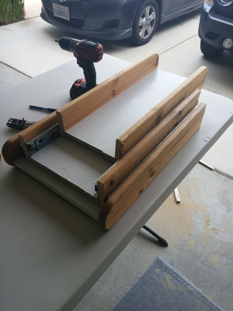

Came across an OLD OLD OLD bunkbed that my brother and I had back in the day. The bed has supplied me with solid wood AND, a slide, ahh the days of waking up and sliding out of bed. Anyway, after a little family outing to Home Depot the ramp is pretty much complete. I am currently working on the drawer system that the ramp will be housed in. I will post a photo of the complete ramp later, I added some grip matting.
The plan is that you pull the drawer out and it will clear the rear bumper, then pull the ramp out and gravity will take over and the ramp will fall into place for the pup. Then it’s as simple and pushing the ramp back up and sliding the drawer back in. I am really excited for this project as it’s a huge learning experience so far and has me thinking about taking some carpentry classes at the local community college. May even check into welding.

@dmurph1996 Wow, Murph! I thought Boozer was pampered before, but that takes the cake! :openmouth: That's a very clever setup. You might build a spare drawer to swap in to use when you need more storage.

That is a solid idea! Pamper, yeah probably, but he is a growing boy and is only getting heavier. Point of the ramp is to save my back and knees down the road

Looks like it's coming along great, how are you going to hard mount it to the vehicle?
