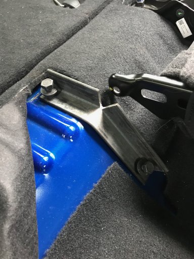

I guess most of you know that you need a braket to hold the small seat in place if you remove the larger section and thats one expensive braket lol.... all in all took about an hour to make and a few beers for the welder lol

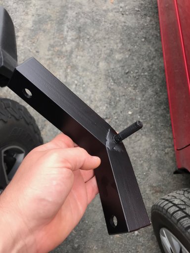

I took a piece of angle iron 10 inches long, cut one side and bent it

the bolt for the seat lines up right about where the cut in the angle iron is

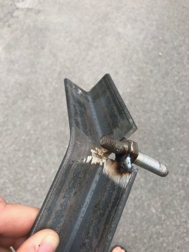

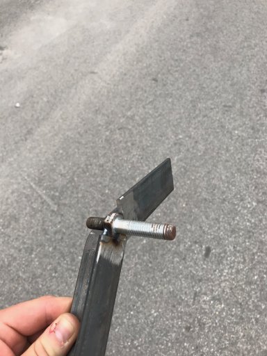

![image1[2096].jpeg](/forums/data/attachments/155/155640-6f0dc842b0a8f4117cf76c358d051b32.jpg)
friend tacked the bolt that fits into the seat for test

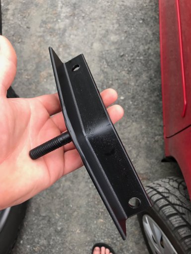

He filled the rest, cleaned up the weld a bit, I painted it. voila,
yes I have to clean the threads because I forgot to mask them lol
![image3[2098].jpeg](/forums/data/attachments/155/155641-6fd30967a171c440dbec7bd71e83f8f4.jpg)
![image4[2099].jpeg](/forums/data/attachments/155/155642-8432edc5d1fe1876d880736f4f8c6317.jpg)
