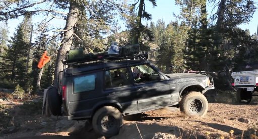

I don't own both, but I think the rear locker is more important.
Why?
I always see rigs have no problems getting their front end over and obstacle, but the rear end seems to have issues. Partially because there's much less weight in the rear to help it stay planted.
There's actually more weight on the rear in the situation you describe (assuming you're talking about climbing over an obstacle). The front suspension gets unloaded and there is little weight to push the tires onto the ground for better traction. So that means the rear needs to handle the increased weight but there's not enough traction and the wheels spin. With a front locker, and just a little bit of traction, it's able to assist the rear help it make the climb.
Here's a pic of my truck in that situation. Notice how compressed the rear suspension is compared to the front? And this isn't much of an incline.
In this case, there wasn't enough traction at either end, so all four wheels were just spinning in place. It's really quick, but at the 29 second mark you can see it in action.
