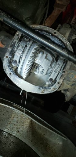

WOW! Did you fill it with milk instead of gear oil?
To OP: Use a piece of fuel line to get it extended up as high as possible and put a filter on the end. Remember that the trans, transfer case and front differential all have breathers as well. The best advice is do not take your rig for a swim! I avoid deep water and walk all water crossings before entering with my rig.

Everything actually survived my little diff ordeal. The jeep drove from Alabama to Adirondack State Park in New York like that, I'm surprised everything didn't burn up

That’s awesome that your rig survived that. Really shows you these rigs are built tough. My old rig went into the shop for a $1000.00 fix it operation.
