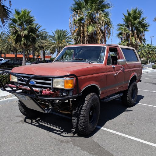

The 1987 ford bronco I've bought has 16.5 rims and tires on it.
Does anyone know if you can deflate the tires without them coming off. If so how low of air pressure is safe.
Thank you for any information you can provide me.
