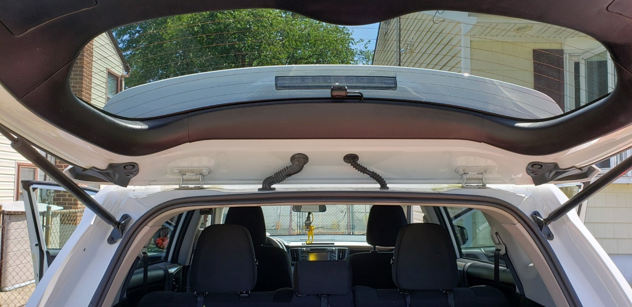

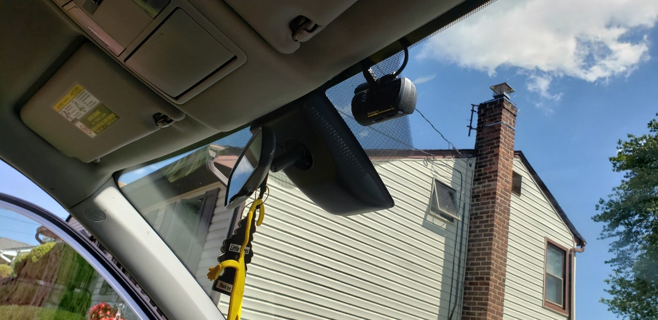

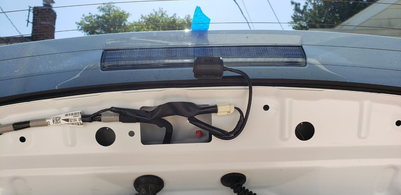

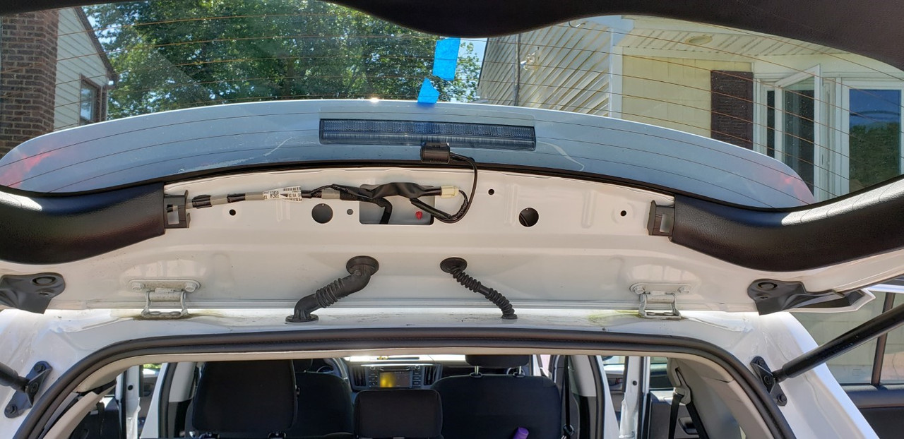

Super simple to hardwire
Just a few pix of a Mini0906 I installed on my niece's Rav4
Took all of 15 minutes to run all the cables down the driver's side and fish through the rubber tube grommet on the hatch
Runs constant 24/7 with the supplied LVC parking kit that plugs right into the fuse panel, but I have them all set to standard record instead of parking mode as a 128GB chip gets you a good couple days of recording before looping over the footage
