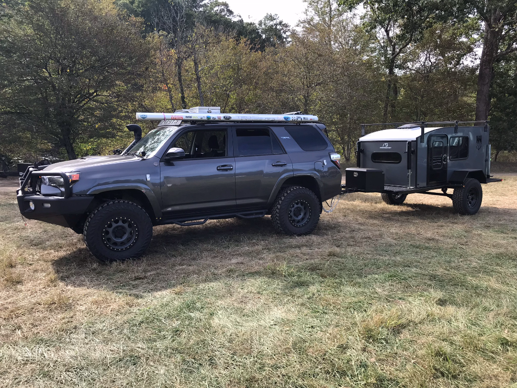

Finally picked up our 5x9 Offroad from Hiker at the Overland Expo east on October 1st. It was a demo at the show for Wes Henry, the owner of the Indiana arm of Hiker Trailers. Below is a photo from when we just picked it up to head home. This thread will track the build and some fun along the way.

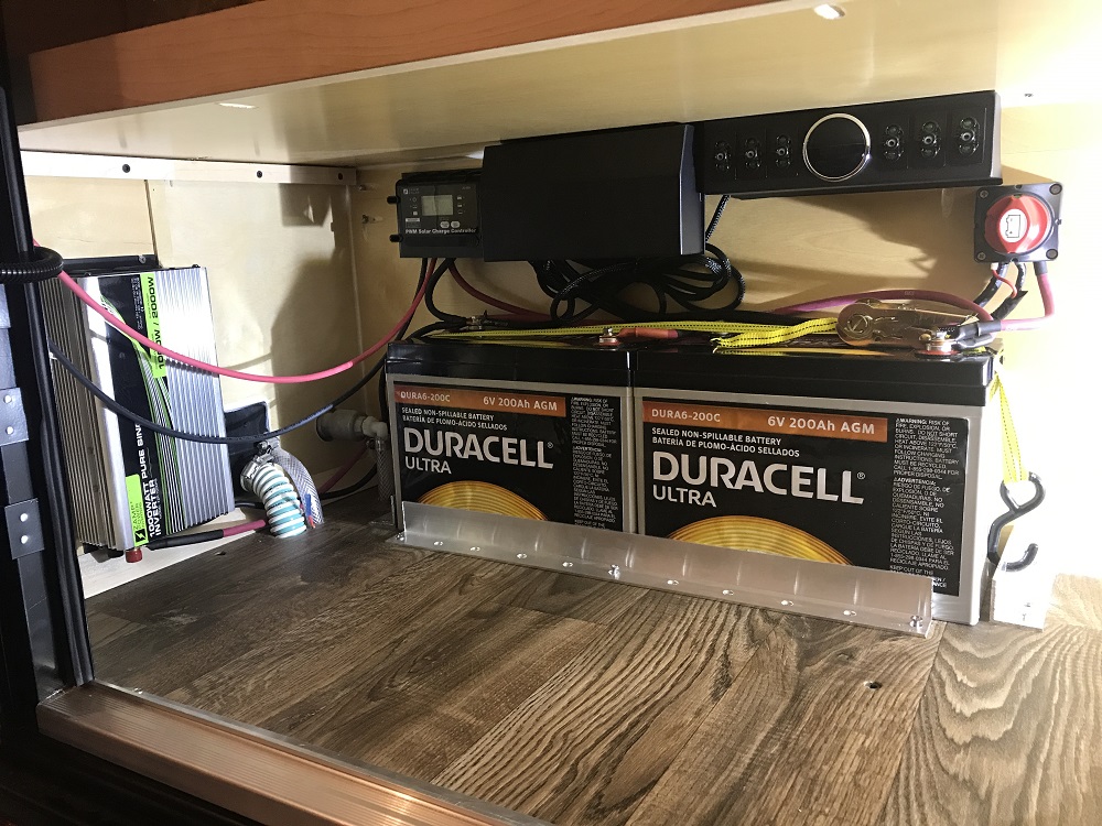

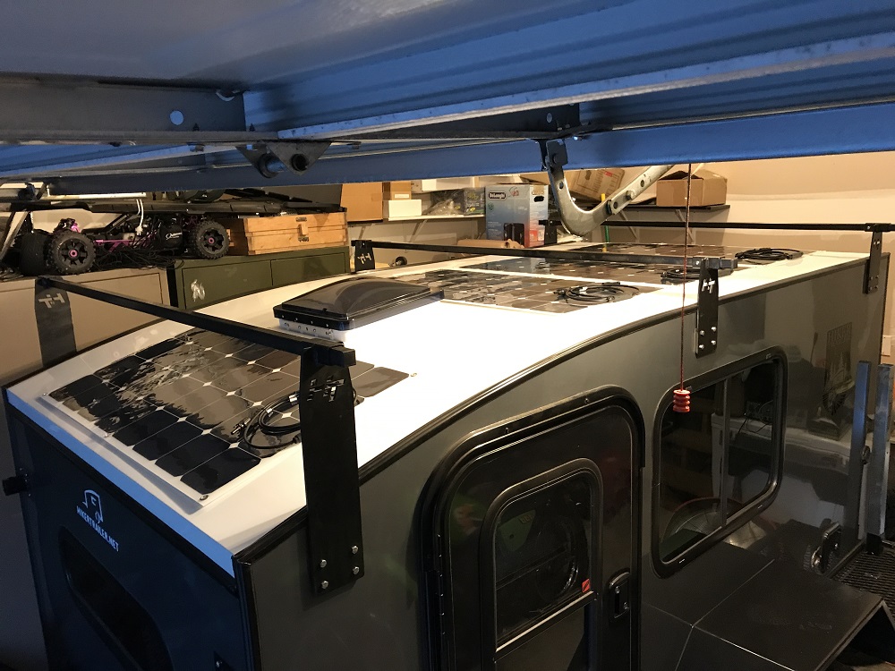

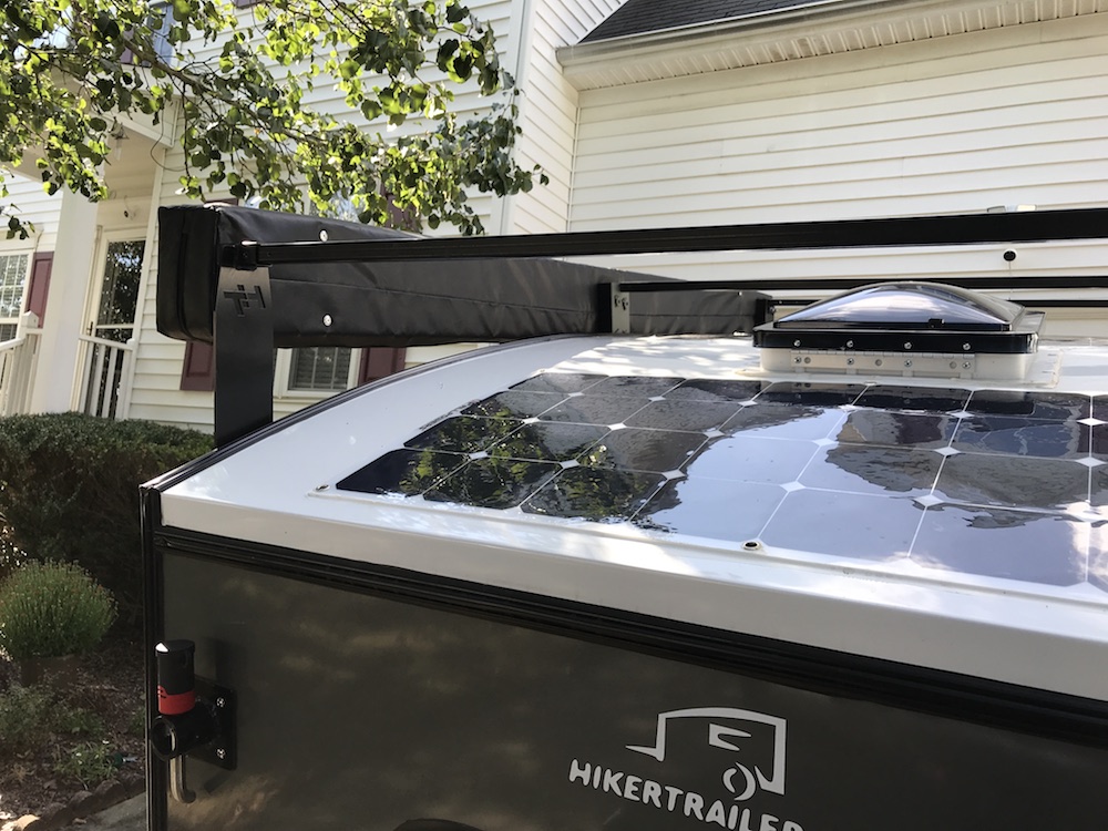

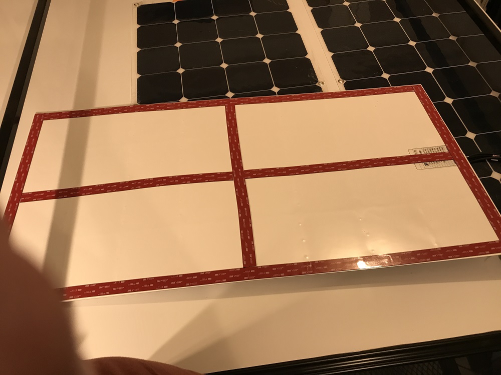

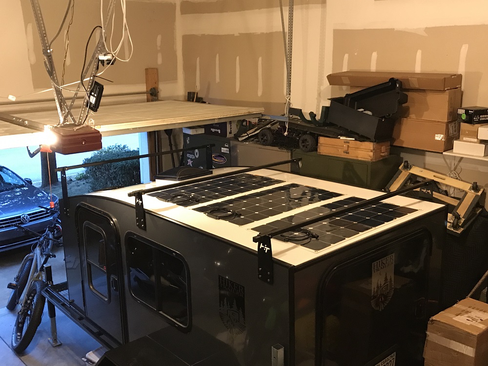

Thanks, folks, nice to finally have it. So, electrics where first, I added four 100 watt flexible solar panels, that were attached with 3M VHB 1" tape around all the edges, and then across the middle vertically and horizontally. Those four panels went into a 60 amp Zamp charge controller to charge two 200 amp 6-volt batteries setup in series. That outputs to a 12v switch panel from ApolloIntech and a 1000 watt Zamp sine wave inverter.

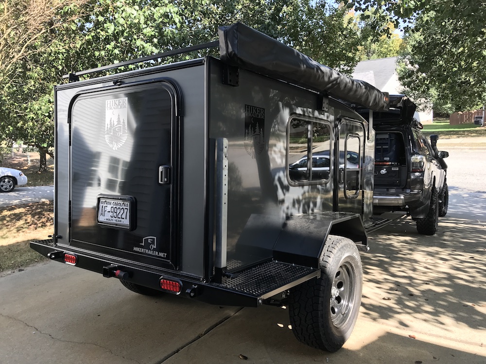

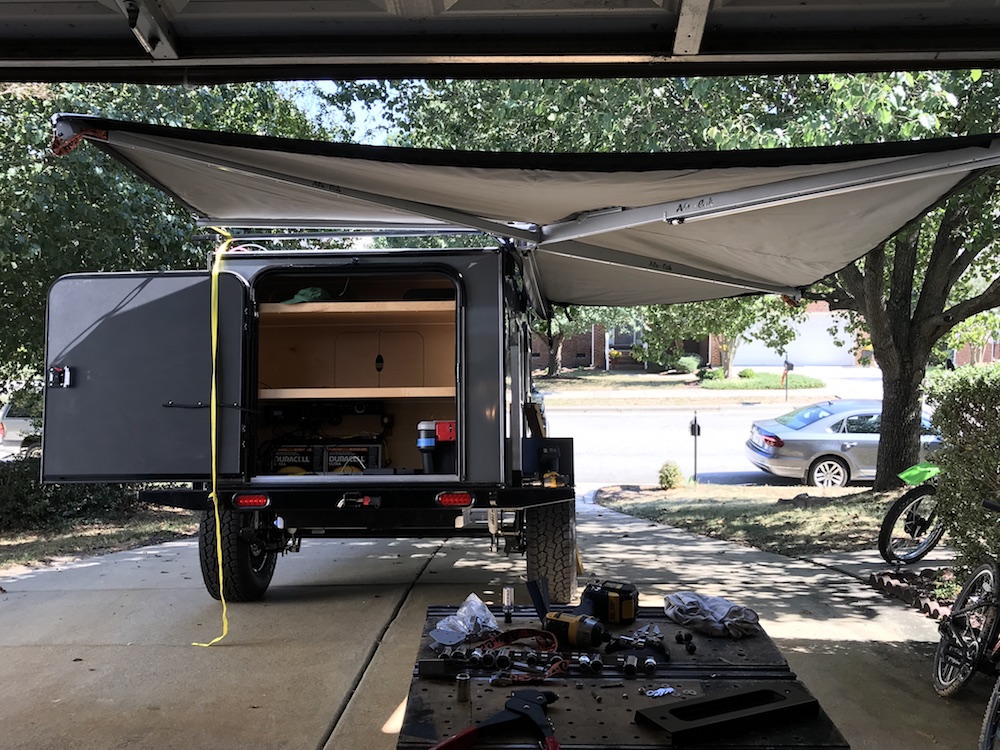

Next up was the Alu-Cab awning ;) I did not want to add any height above the roof rack and I also wanted to reduce any wind/rain/etc from entering the gap that would exist if the awning was above the rack. I fabbed up my own box section to use the existing crossbars and allow a solid connection point for the awning to the trailer. (More photos on that later). Here is how the awning looks attached.

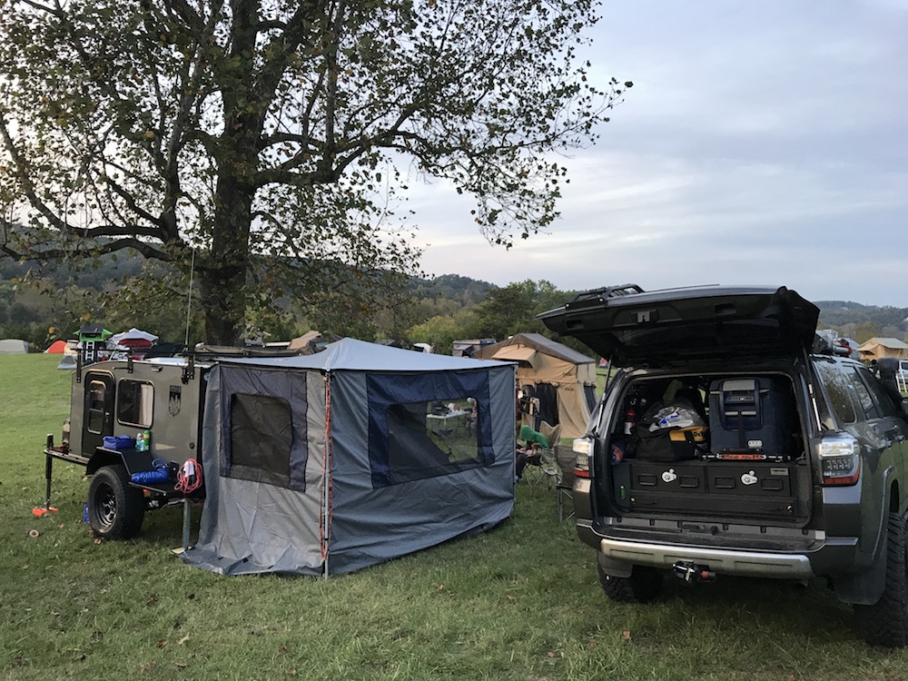

We attended the first Roof Top Tent rally at the James River state park in Virginia. It was a great weekend and it was the first trip with the Hiker. A few minor changes are in order and some lighting updates. Otherwise, it was a great time and I would recommend it for anyone.
