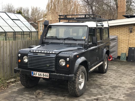

This is our 110" Land Rover Defender..
The daily name is "Turbussen" which is the danish word for TourBus.
We are My girlfriend and myself, and my dog. And some times our 3 kids.
We use the Defender for weekend trips, scouting trips, and family holidays.
Weekend trips to Sweden is at the moment the favorit overlanding exercise, as it takes about 3 hours and we are in the forest of southern Sweden.
We are trying to build a map of amazing spots to spend the night.
Long term plans are:
Overlandtrip around the baltic sea (2-3 weeks)
Overlandtrip around Norway, Sweden Finland
We owned it for about 10 months now, and made some upgrades to it.
We´ll start from the beginning.
Nov 2017 - As we bought it. - 2 Inch lift, Raised Airintake, Snow Scoop, for heater intake, Rocksliders.

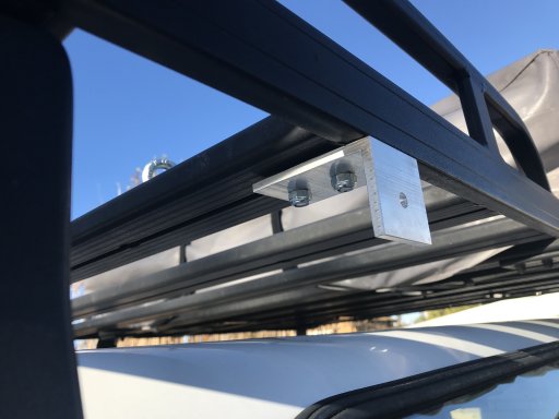

Brackets for the Awning

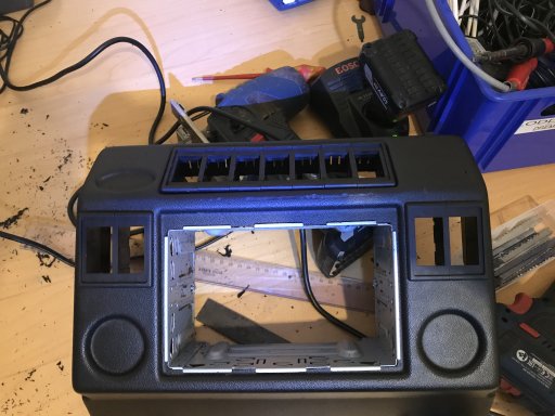

In the spring i decided that the stock radio, and lack of switches wasn´t cutting it.
I Need switches for the winch controls, winch power, led lights all over..
The car had a mudstuff consol alreeady, but i ordered a blank canvas and started my own build.
Layed out the graphics.
And then on with the cutting job.

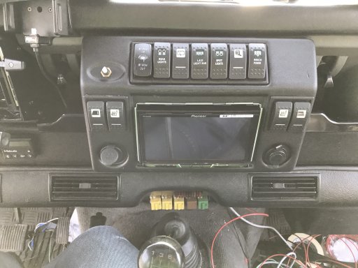

The old consol is out and i´m wirring up the led relays, winch controls and winch power relay.
After 10 hours work, i finished...
Think its an OK result, the finish could be better....
Being a defender the shift lever clearense is MINIMAL... Like les then 5mm... and a quick shift will make my hand hit the display.

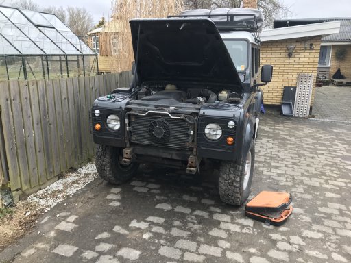

Winch Mount...
The winch, is mounted in a Masai Winch Bumper made to fit an Aircon fittede defender...
The Aicon makes the front stick out furterh 5cm.. So the bumper comes with 10cm extenders..
Original Bumper setup, with the cooler stacks behind.
No Bumper (looks naked to me :-) )

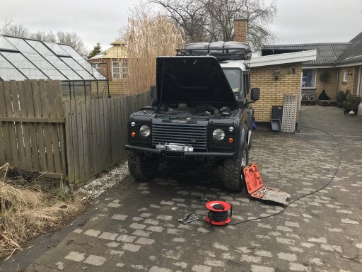

Bumper and Winch Mocked in to place.. the front sticks out like a sore thumb...
Wasn´t happy about the setup.
So i stripped back down again.
Checking the clearance for the cooles and front "body"

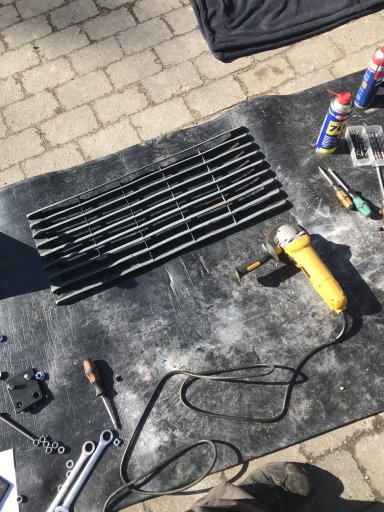

Cutting the grille to fit the winch
Test fitting the grill
Test Fitting the winch
Looks MUCH Better tugged thos 10 cm back.. Much cleaner looks.
