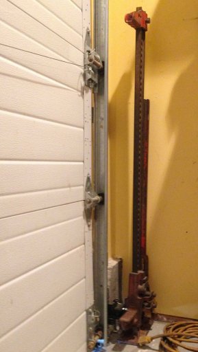

I’ve had one for over 20 years and never used it .
same here....
But the reason to leave it at home is for the safety. In BC no government vehicles carry a farmer jack anymore due to the high incident of injury and Workers Comp claims. I know the highlift fan boys will be all over this comment but the fact is, statistics show the highlift jack is a dangerous tool.
Mine stays here till I need to pull out a fence post.
